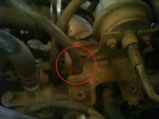

Looking at the left hand side of the manifold I had a vacuum line left over after re attaching the air cleaner.
I found another pipe that it may have come off but it appears to go back into the manifold right under the carby which doesn't make sense as it nearly rubs the throttle body.
I'm stumped. Any ideas guys?

I'm 99% sure that goes to the underside of the air cleaner

that is correct it goes into the air cleaner and if I remember correctly from my own car it goes into a fitting with a similar clip to the one on the engine.RSR 555 wrote:I'm 99% sure that goes to the underside of the air cleaner

I thought it did too. But I couldn't find where it came off of.
There is a inlet to the air cleaner above the distributor that has been blanked off. Maybe it has been hooked up wrong for awhile.

When you lift off the top part of your air cleaner, you will see on the 'drivers side' a little by-metal valve deal.. well the hose connects to that but on the underside

ChPLAT wrote:That's it!
Except it had the pipe and the little 90 joiner still attached. No wonder I couldn't find it.
Thanks heaps, I am in your debt guys.
