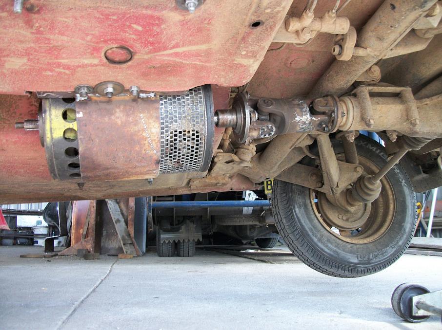

Firstly; apologies to Alex of Kellyville Ridge; the head teller said no to my intended purchase. My query is: If the main gearbox is in neutral, will high & low range still provide drive to the rear diff only? You may remember that I fitted an electric motor direct drive to the diff but it was too high to take off from standstill. I have since fitted the electric in place of the motor and it worked better but still limited by s/h batteries and no funds. 60ks top speed but the volts died too quickly. So I re-fitted the motor and this time plan to have the electric motor connected to the diff as before and to the gearbox as well. So the electric will work as a hybrid in 4wd : getting the throttle setting even will be an issue but will give a power boost (think Camry ad). So will it give rear wheel drive only in neutral with 4wd engaged? I have seen the posts from the Brumby owner wanting to drift with rear wheel drive only. Mission Impossible?:confused:

If the transfer case is in hirange 4wd and the elec motor is connected in series to both gbox and diff, (3.7:1) ; then we have a true hybrid with the elec as a power boost. What is the safest road speed and for how long without damage to the tranny?:(

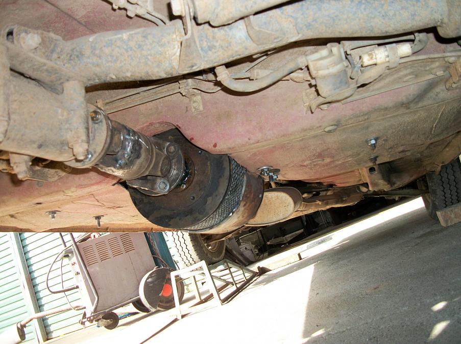

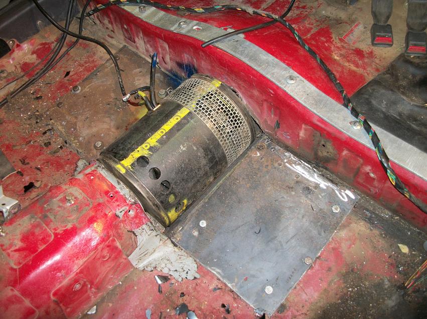

:confused:If the pics come thru you will see the elec motor bolted to diff. If a shortened tailshaft is fitted to the front of the elec and to the rear of the gearbox this is the same as the original drive.So how fast and how long in 4wd high? This gives 4wd with elec boost like the Camry hybrid; or it can be fwd petrol or rwd electric.The elec motor is DC series so it doesn't matter if it freewheels when in fwd

the problem is that there is no centre diff. It should work the same as it did with just a straight tailshaft, ie. don't engage 4wd on hard surfaces. I guess that with the box in fwd you could still add some extra drive from the electric motor to the rear wheels. Also, if you had the box in neutral and 4wd engaged, it will drive all 4 wheels, but then you're back to the problem of no centre diff. Hi/Lo in this case has no bearing on anything as the drive you are applying from the electric motor is past the low range gearing.

I just had a second look at the photos. Looks like an 'L' series?
the centre diff is to allow the front and rear wheels to turn at different speeds while cornering. The problem is, you don't have one. So if you engage 4wd while on bitumen and try to turn, the whole drivetrain will bind up. Your tyres will scuff and chirp, it will be hard to turn, and eventually you will probably break something.
