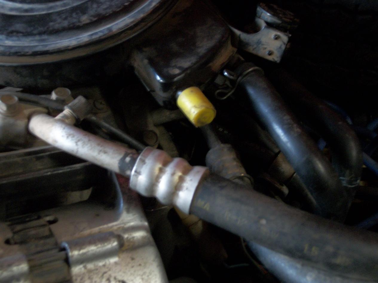

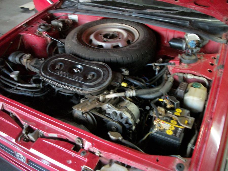

Hi; Can someone identify the function of the yellow capped pipe on my 1/89 L wagon? (see pics).You may remember that this is the electric subelec. I have re-fitted the EA82 as my affordable battery pack was not powerful enough for electric only; so the electric motor is bolted to the diff again and the car is a dual power or petrol or electric hybrid, but not 4WD.Then again, all 4 wheels can drive at once, but with separate throttles. Good for acceleration bursts or hills. This is the only fitting that I can't work out.:confused:
Post by guyph_01 » Fri Dec 31, 2010 7:49 pm
I would not worry about it. just keep it blocked. I think its not important. If its annoying that its yellow just spay paint it gloss black and no one will know:)

Post by FujiFan » Fri Dec 31, 2010 7:55 pm
I have the same thing on my EA82, but with a red cap, which was fitted by previous owner. Totally useless and only related to PCV system. Treat as guyph 01 said.
Post by steptoe » Fri Dec 31, 2010 8:46 pm
I think they were capped factory at this point and over time the black factory cap was lost or rotted and replaced with whatever was around at the time

Post by RSR 555 » Sat Jan 01, 2011 1:09 pm
Originally this outlet had a pipe that was open to atmosphere.. it would draw warm air off the engine for cold mornings. Most owners blocked them as we didn't really require them in Aus.

Post by poprock1 » Sat Jan 01, 2011 8:41 pm
So is it a different function to the hit air intake from the exhaust to air filter?:confused:

Post by RSR 555 » Sun Jan 02, 2011 12:28 am
Hot Air comes off the exhaust.. Warm Air comes off the engine.. according to the WSM :)

Post by RSR 555 » Sun Jan 02, 2011 1:12 pm
hehe.. no probs bud.. WSM = WorkShop Manual
and yes this pipe that you are asking about is different (but similar purpose) to the stove pipe that comes off the exhaust system :)

Post by FujiFan » Thu Jan 06, 2011 10:46 pm
Just to push this thread a bit further, I can explain that the second outlet on the Carb airbox is for the Air Injection sytem on carb models. Mostly not noticed but is just pollution control device. Acc to Sub WSM designed to inject fresh filtered air into exhaust pipe (#2,#4 cylinder Ehx port) to reduce HC emissions when engine is cold.

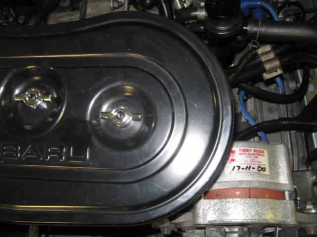

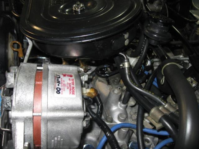

Well always looking to find stuff to remove and generally waste time:rolleyes:. I decided to remove the useless "mystery pipe" and the little box next to it. see attached.
I trust this will be of no use to anybody, but since its a slow night...
