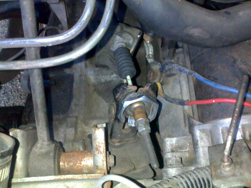

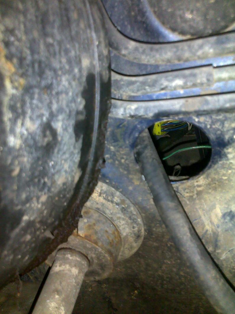

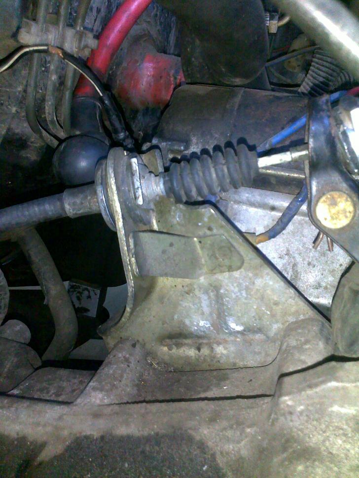

, i've decided to have a look at the clutch, i took the intercooler off to have a look at where the clutch cable joins the trust bearing arm and found a bit of a home made arrangement, looks like an old spark plug outer has been used, does anyone think this could cause my clutch judder? i'll try putting up some photos, if not its down to getting to the clutch, any advice, i don't have an engine lifter but i have got ramps and axle stands

The shuttering will come from the clutch itself (I'm putting money on a shinny flywheel) That "homemade" cltch fork mod would be ok as long as its got lots of anti-seize grease on it.
