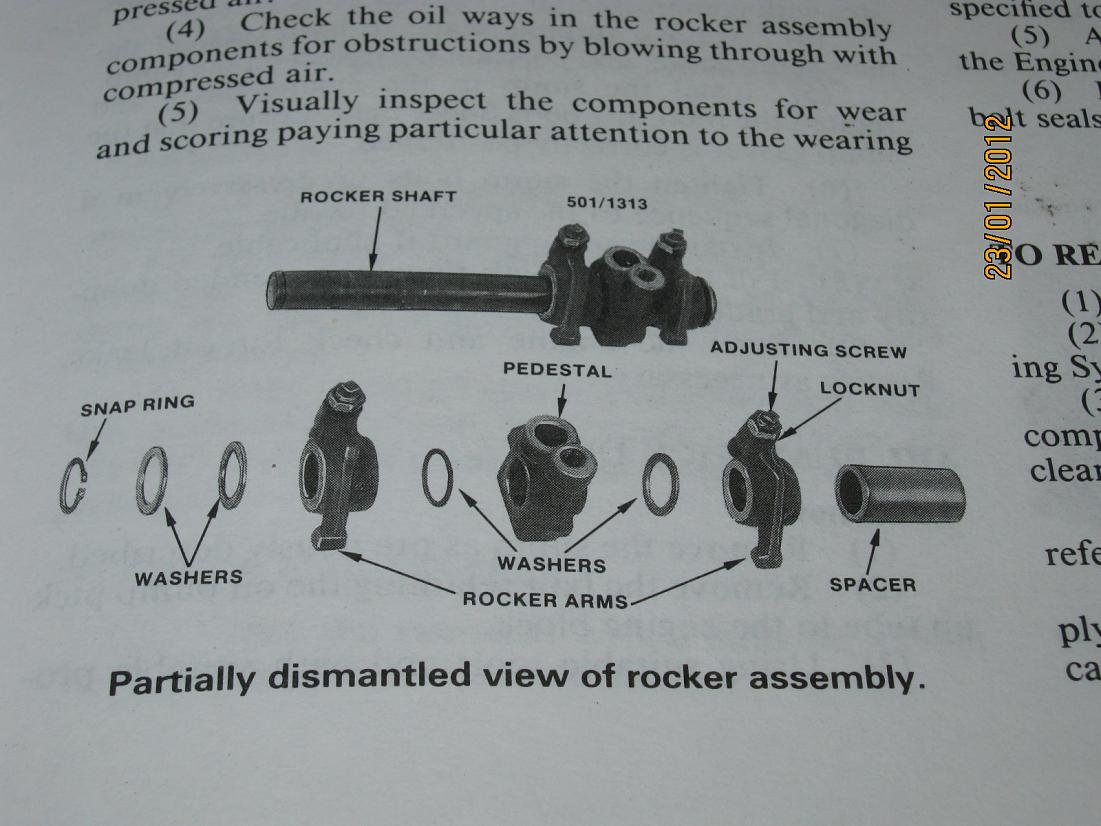

From memory the assembly is stamped with numbers also.
Photo from Gregorys.
Some washers are spring style and some are just flat

thinking they were made as left hand or right hand side bends in them ????

Have seen a couple of diagrams re flat and spring washer position, I'm happy with that. The spring washers seem quite worn, will investigate new ones.
