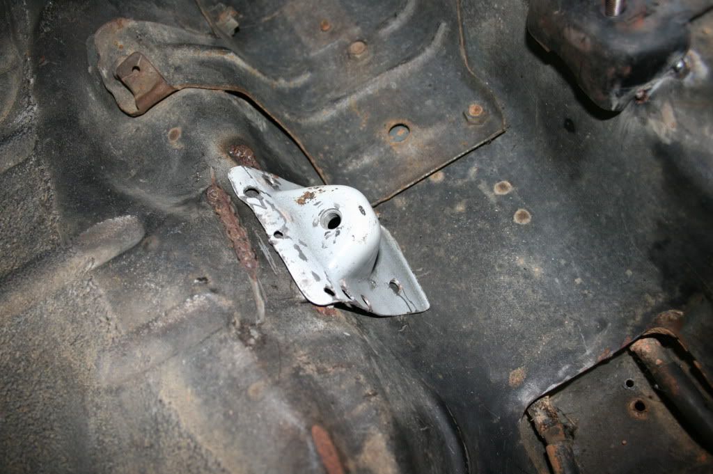

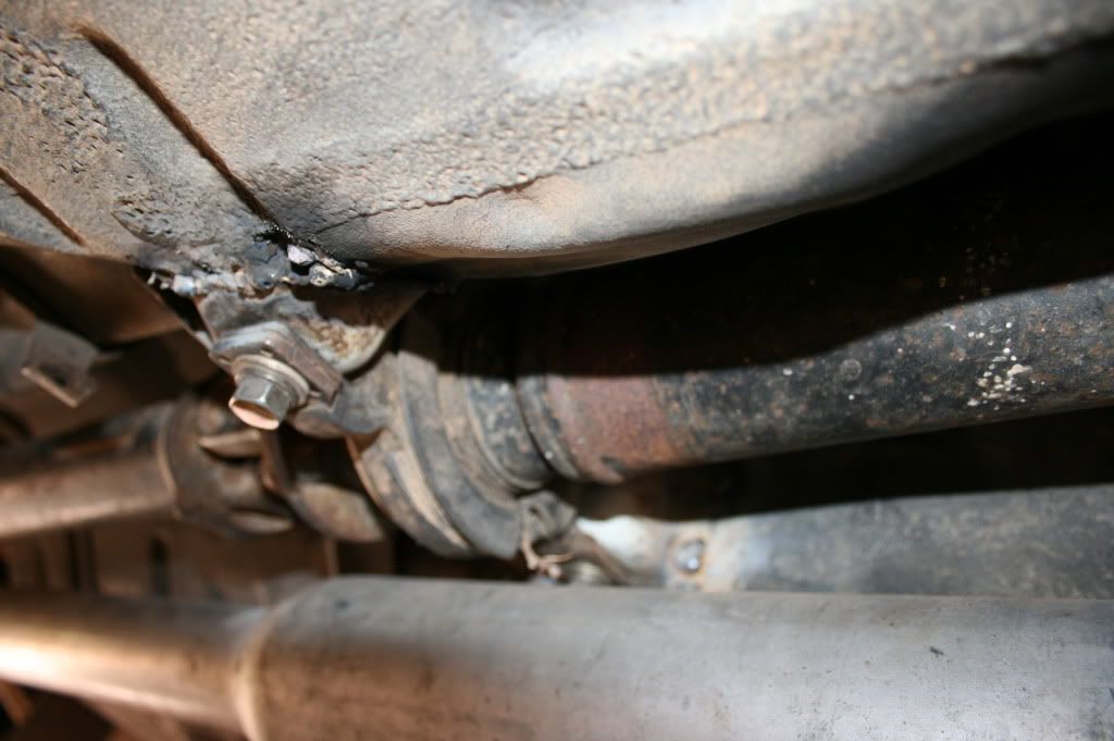

darn why didn't I think of that before I wrecked the Lsuby rebel wrote:Yes you will need to use the L tail shaft you will also need to do something about the center bearing I drilled out the ones from a L wagon
