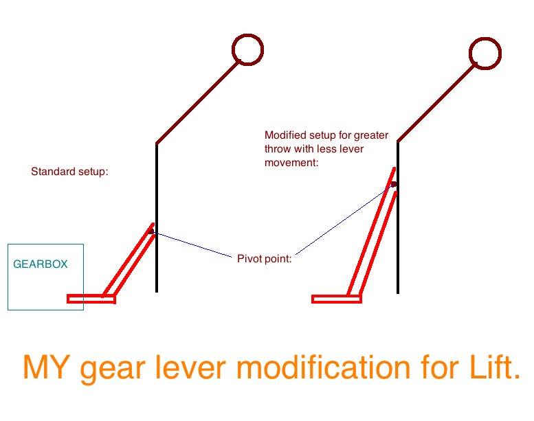

Post by El_Freddo » Mon Dec 17, 2012 12:28 am
I'd be trying to do this with the gear selector boot remaining where it is.
I've heard of people re-jigging the gear selector lever by cutting off the point where the selector rod from the gearbox joins the gear stick/lever to a higher point. This requires the diagonal piece to be redone as well to meet the higher mounting point. This will give you more movement or throw in the gearbox for less gear stick movement up and down or into 1st and 2nd etc. I won't change the throw left to right, there's nothing you can do about that.
Hope this is clear as mud ;)

Posts: 12708
Post by El_Freddo » Mon Dec 17, 2012 3:48 pm
Brumby Kid wrote:Bugger.
Yes Bennie clear as mud.
I have no idea now, apart from putting the boot back in and cutting out the bit that stops me from selecting reverse.
Hopefully this will show it better to you...
