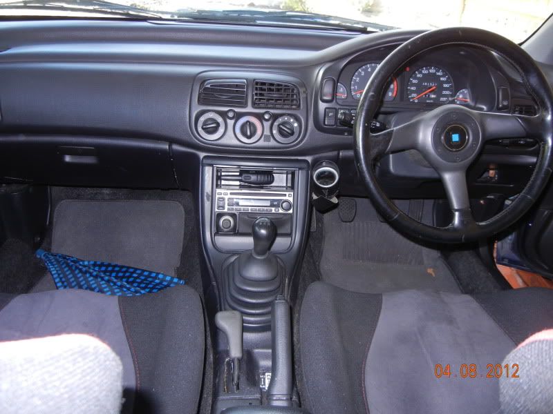

Why not just cut a slot in the console you have now? It's what I did here.

G'day,bensmith87 wrote: I think this is how the cable is ment to run...
The cable position is incorrect, it should be on the right side of the shifter, if you leave it like that you'll notice shifting doesnt feel right as its rubbing.
