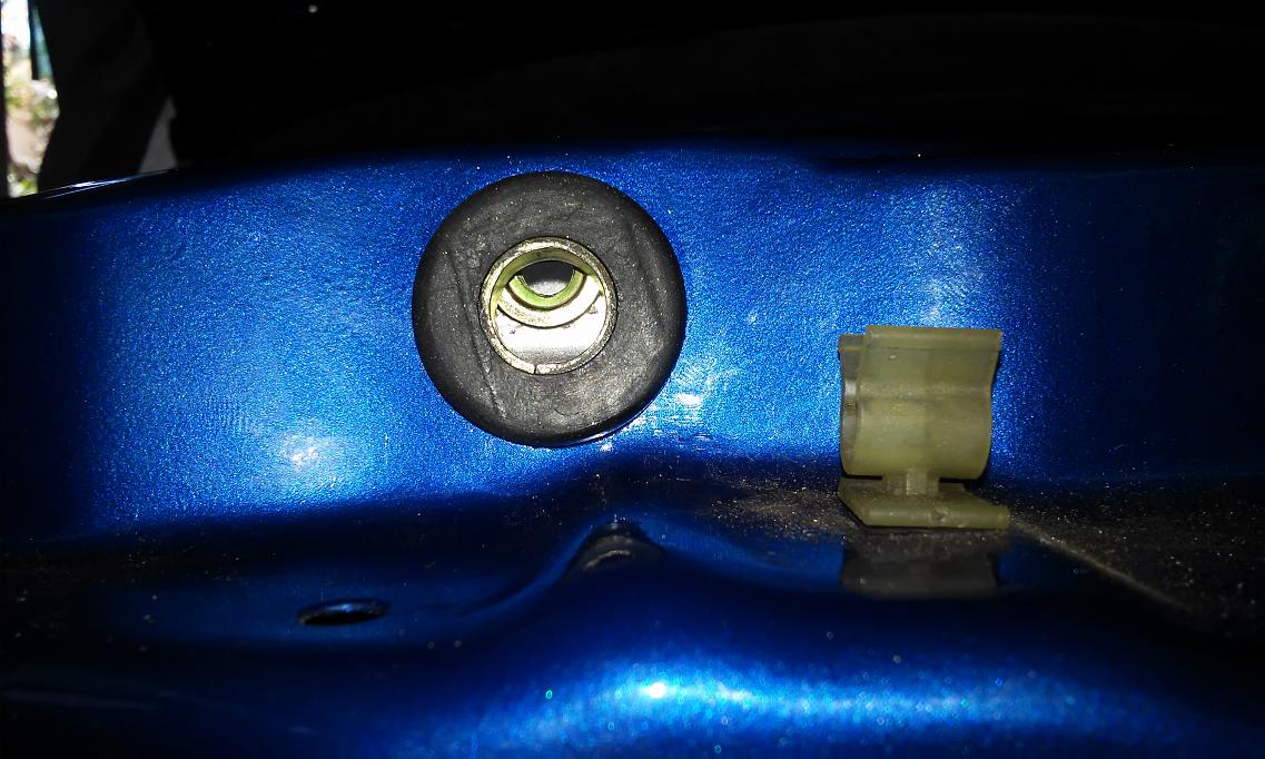

Just getting round to fitting my ebay special to the wagon now, having a few problems :( Not so simple as just dropping it in where the old one went. Seems they have a very loose assembly jig when they weld the brackets on where the mounting holes go, or very open tolerances on where the holes should be. The bottom locating pin holes are in the right place roughly, just spaced way too far away from the rad so I end up with the situation in pic below. Originally I couldn't even get the top of the rad under the lip in the bodywork inside the engine bay, had to grind 5mm off the top for it to fit under while squashing the rubbers down below.
I'm thinking I will just cut a big square piece out of the rad to remove these riv nuts, weld a thicker blank piece of ally over the gap and drill my own holes.
