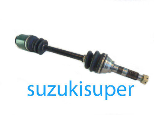

Ye can tell the type of shaft by the shape of the external housing ( Sometimes ) :
  • 6 cage bearings ones are almost round on the outside ( It may have Flat spots corresponding to bearing locations ) ...
  • While tripods should have a distinct '3 sided' shape ( not always ) ...
If nothing is visible - The other way is to take a 'feel of it' through the boot ( don't have to take a boot off ) ... Don't know if that helps Ya, but we should try a get some examples together & post them here for later ... :???:
Add : http://www.ebay.com.au/itm/Fits-Subaru- ... 1694724570
Or : http://www.ebay.com.au/itm/DRIVETECH-CV ... 1694724570
Ciao, Bantum ...
