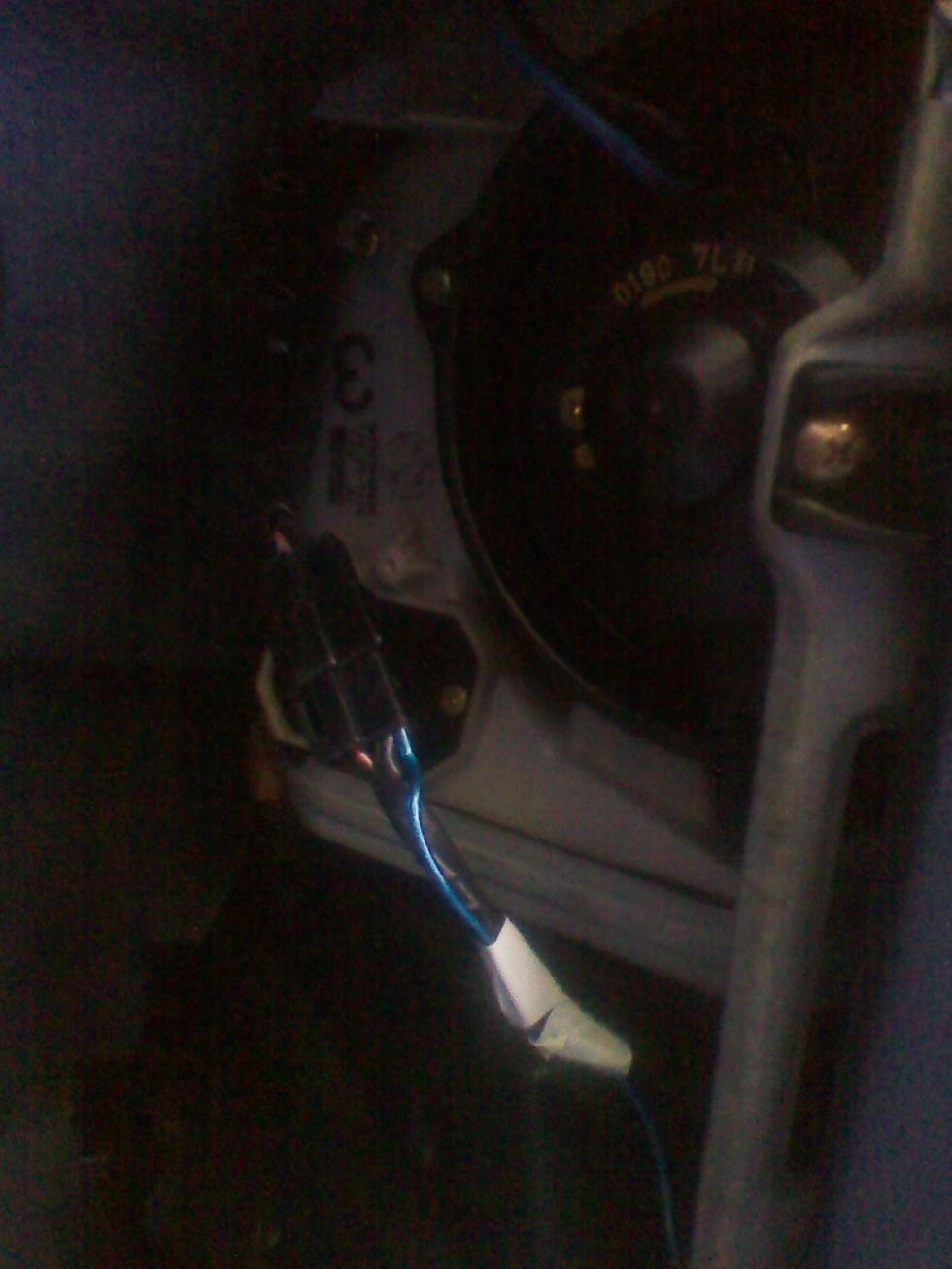

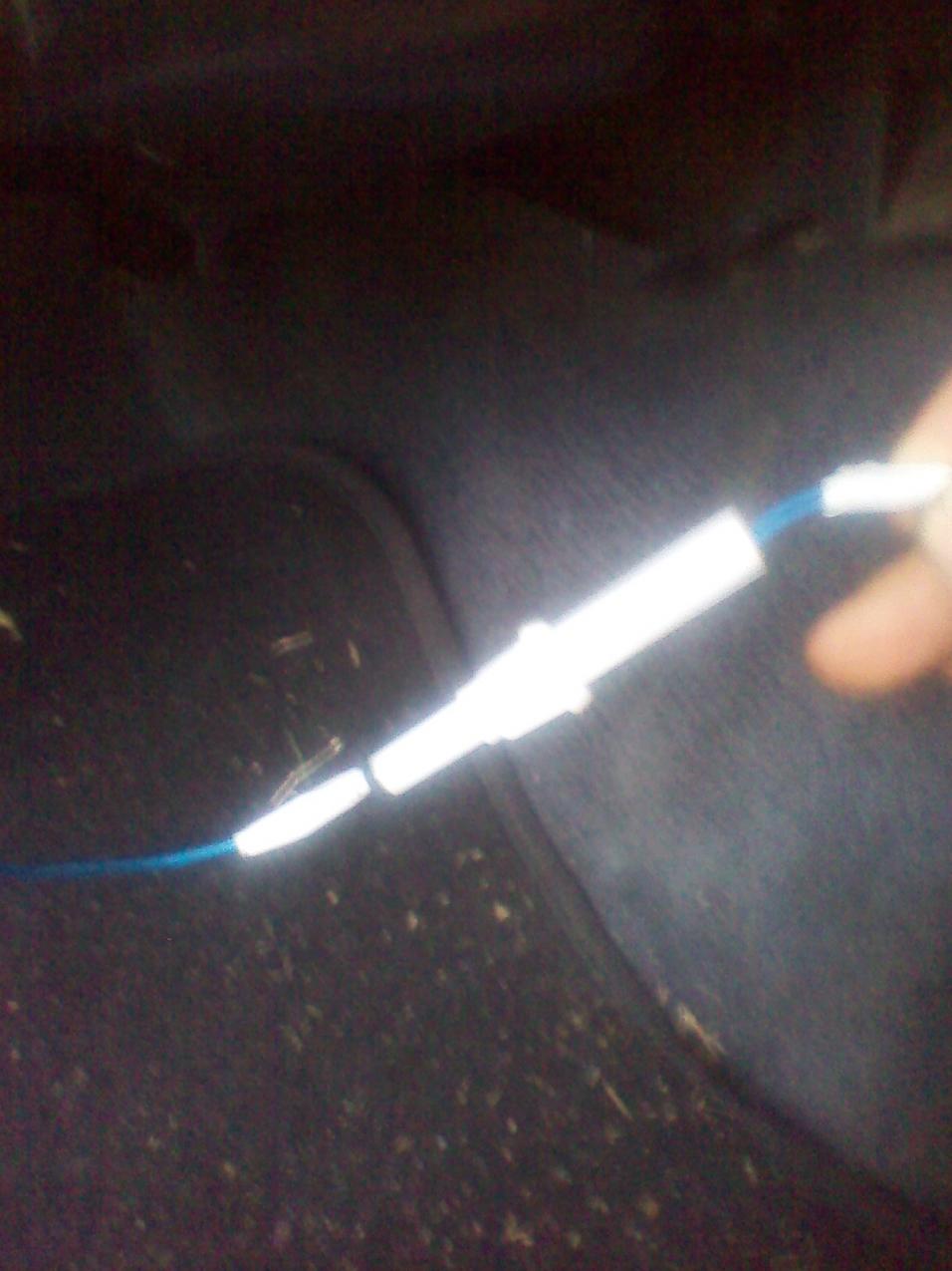

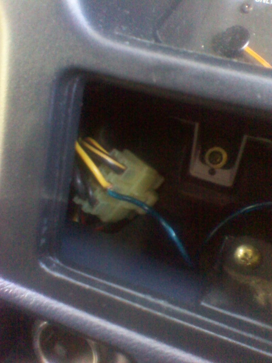

ok guys! this what i have done to work my heater!!!!
i ran a blue wire conecting from a b/wite wire from the fan then ran it to a sepret fuse, then to a y/green wire inside the removerble panal as show in photo
is the new wire i ran ok?:roll:

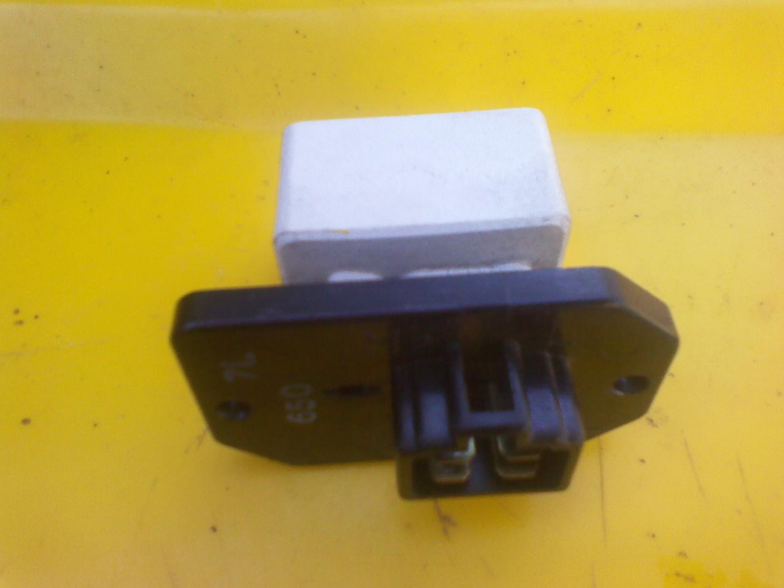

Gday usually the fan will stop on certain speeds if the resisters are blown,,near your clutch pedal just to the left is a plug(i think its a 6 plug with some yellow wires)take out the 2 screws and take out the plug(it contains the resisters for the 4 fan speeds)replace that and your done..

if not there look behind your glove box(will need to take out the backing to the glove box)but it definatly sounds like thats the problem,,i have had the same thing happen before and took me ages to find it out.

cool! thanx justin.. is this the fan speed resister? theres a wite cover on it an i cant see any coils
if it is! how much you reken that part will cost? (cant get to an auto place untill tomorrow some time)

that looks like the culprit ,replace that and you should be in business again
