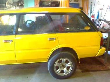

Post by L-Raiser » Thu Nov 27, 2008 10:07 am
Yep....she now sits 2" taller with lift kit and an extra 1" taller with the Forry wheels...NIIIICCCEEEE me likes! GRIN :-D

Post by Subafury » Thu Nov 27, 2008 11:15 pm
thats looking and sounding better. congrats. your mechanic isnt gonna want to see or hear from you again tho!

Post by L-Raiser » Fri Nov 28, 2008 9:37 am
Subafury wrote:thats looking and sounding better. congrats. your mechanic isnt gonna want to see or hear from you again tho!
need way more pix too.
can you do a rundown of all the forry parts and upgrades now in her- to save scrolling
Hi Matt, cheers.....Yeah when I get her back to my place I'll be taking much more pics and make a list of all updates and modded parts in her now. This pic was just a teaser, it was taken on my mob phone while at the shop the other day. I'll prolly start a new thread in the MY CAR section or the WA folder.
