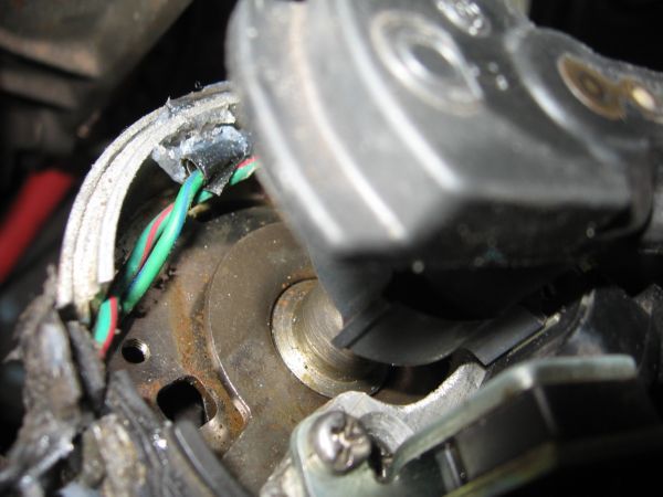

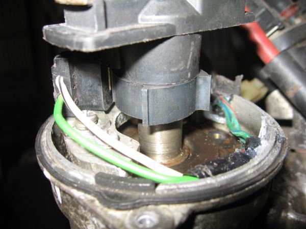

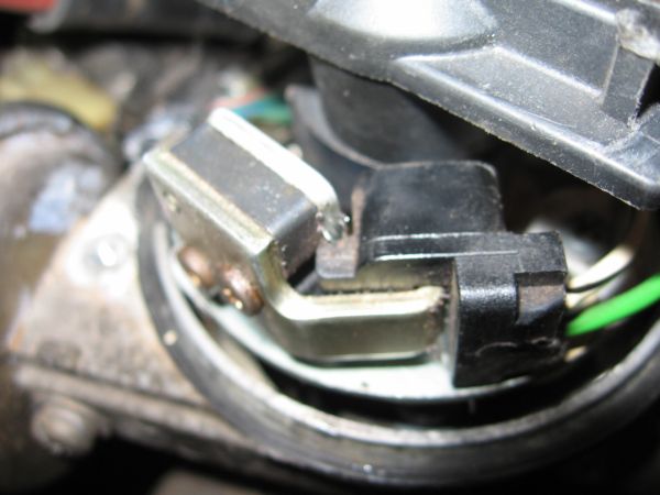

crank angle sensor on ea82 for wolf3d
hi all
hear are some pic
hear are some pic
- disse pics resize.jpg (49.84 KiB) Viewed 4410 times
- disse pics (2) resize.jpg (43.4 KiB) Viewed 4407 times
- disse pics (1)resize.jpg (44.67 KiB) Viewed 4410 times
- phillatdarwin
- Posts: 532
did the pics help u
if u look at it u can see that the pick up is on a castom plate and u have to weld the shafe up all the bits on the inside so it will not move .
