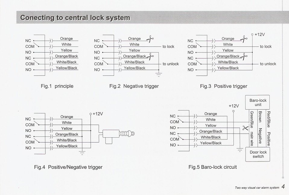

The alarm is a Steelmate 888, the manual has the following options:
Can anyone give me some tips how to hook this into the Subi wiring ?

its a single wire setup. open circuit it and the thing locks all 4 doors. (wht wire in drivers kick.) so if you wire up the relays to open ciruit the wire on lock and ground it for unlock it will work fine. forget about sticking another one in the doors its already there - use it.
Audio Express
1987 HR31 Nissan skyline
1990 R32 Nissan Skyline GTS4
Post by Gannon » Wed Apr 21, 2010 10:35 pm
Chris_Rogers wrote:its a single wire setup. open circuit it and the thing locks all 4 doors. (wht wire in drivers kick.) so if you wire up the relays to open ciruit the wire on lock and ground it for unlock it will work fine.
Tried it, it doesnt work. I tried the relay in series with the door sw, it would lock but wouldnt unlock because the door sw became open when it locked. I tried it in parallel but wouldnt lock cos when the door is unlocked, the switch is closed and makes the relay useless.
Chris_Rogers
Posts: 1155
Post by Chris_Rogers » Thu Apr 22, 2010 10:06 am
it does actually. if you ground the side of the white wire that feeds the car and not the door then it works fine.
now in relay speak:
relay 1
87a - door side of white wire
30 car side of white wire
87 - nc
85 - +12
86 - alarm lock wire
relay 2
87 - gnd
86 - alarm unlock
85 - +12
30 white wire car side.
give that a burl.
