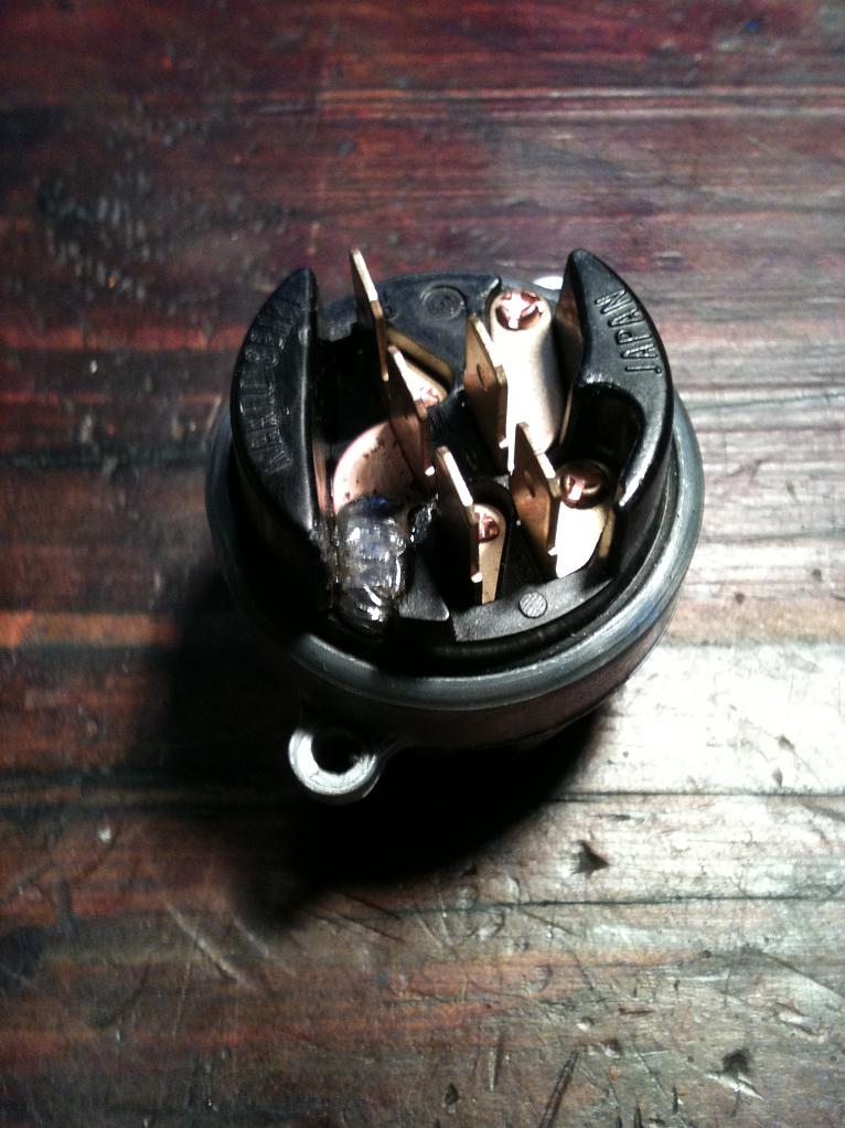

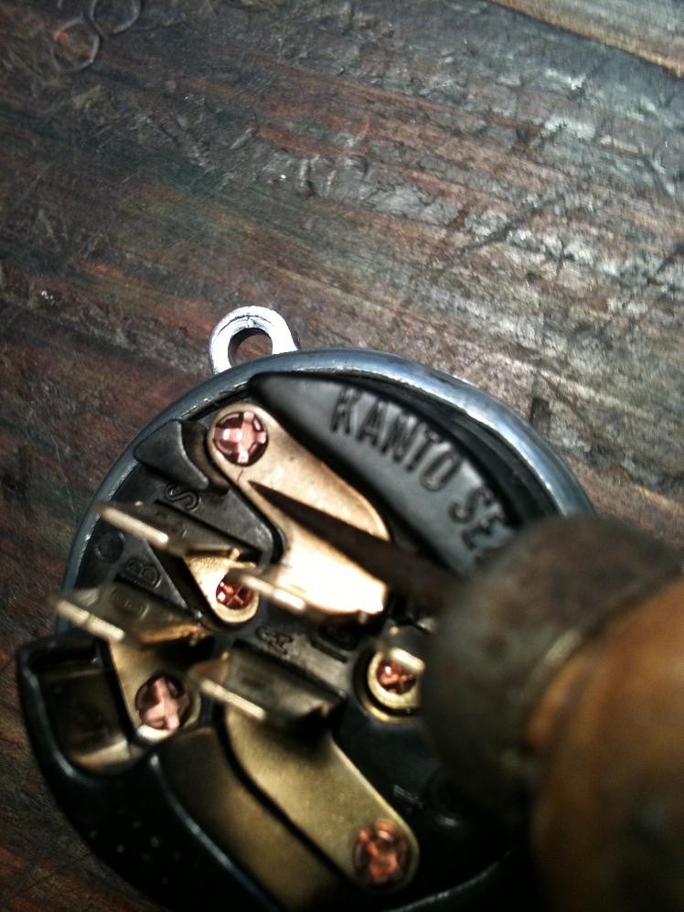

I had the exact same problem - just like Toonga says check for hairline cracks in the back of the switch (drop the two bolts out of the steering coloum to make removal far easier!! :D)
Despite it only being hair line these small cracks WILL stop a current passing !
Check out these images one shows the problem the other a very cheap quick and certain fix ! Careful and accurate soldering works a treat - if you cant do this yourself its worth paying a good electrician to do this for you and will be a bucket load cheaper than a replacement part !
Cheers and good luck from snowy UK !

Thanks guys. No cracks on mine at all. basically if i hold the key at a certain point (just before start) it registers as on so im pretty sure its something inside and not the connectors. Plus two pieces of metal fell out of it when i took it off so i think thats not a good sign anyway

openflame06 wrote: Plus two pieces of metal fell out of it when i took it off so i think thats not a good sign anyway
OOOOhhhhh -sounds a bit fatal to me mate ! - I'd just bang on and change the thing if I were you !
