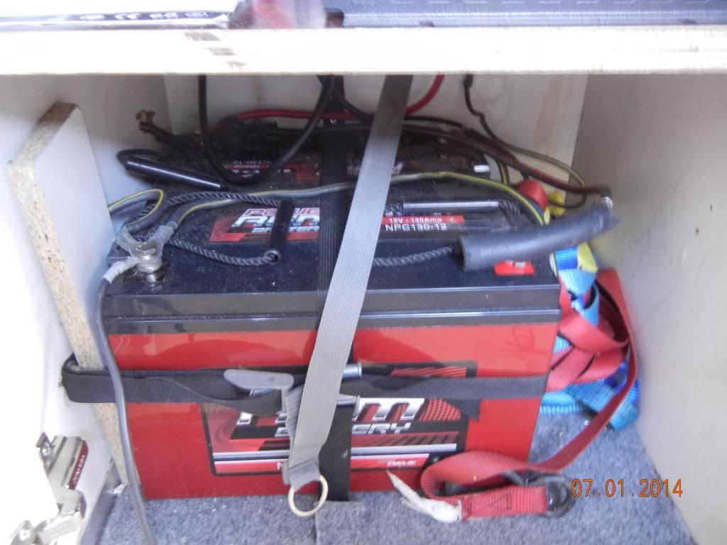

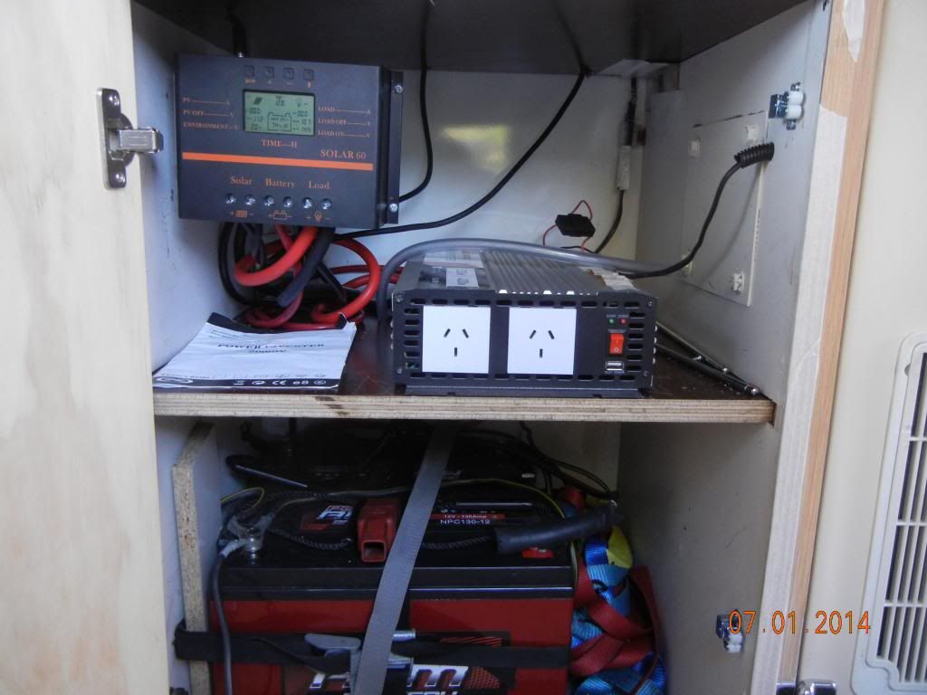

How about I pay you to look at it, I'm only 10min up the road, fitting stereo's when I was 18 I understood, this stuff is beyond me, like my daughter teaching me how to use an Iphone yesterday..........aghhhhhhhh, I'll try to get the son in law to read it but when he did yesterday he said it was not much good.
Some pics of the set up

Yeah mate, you can swing around. Weekend suits me best but can do after work. No need to pay me to have a look, Will be nice to check out your rig ;). Il give you a ring tomorrow after work.
Arh so there is a controller for the batteries and panels. A quick search online pulls up the specs on that solar 60 controller. Can handle up to 48v input from the solar panels so switching from parallel to series should be a piece o cake.
http://www.chinasolarregulator.com/sola ... r60solar80

Post by tambox » Thu Jan 09, 2014 5:23 pm
Often regulators cannot take the load of an inverter on their load connection, it only designed for a light load, like lights.
The simple way is to connect the inverter straight to the battery.
The panels through the regulator.
Then do your maths, how much does the fridge need, how much can the batteries store, how much can the panels provide (these are usually rated with the panel facing directly at the sun, if the panel is not facing the sun its output is reduced)

Post by d_generate » Thu Jan 09, 2014 11:54 pm
Thanks Tambox, you are 100% on the money that's pretty much what SubyDoug did today, we put the inverter back on the battery's after he stripped the guts out of the inverter and found one of the screws was put literally fraction of mm's in the wrong position causing a short in the heat soak chassis, a plastic screw fixed it, I can't thank Doug enough for his time and patients........and his boss to a lesser extent for sorting part of my problem.
