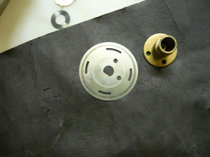

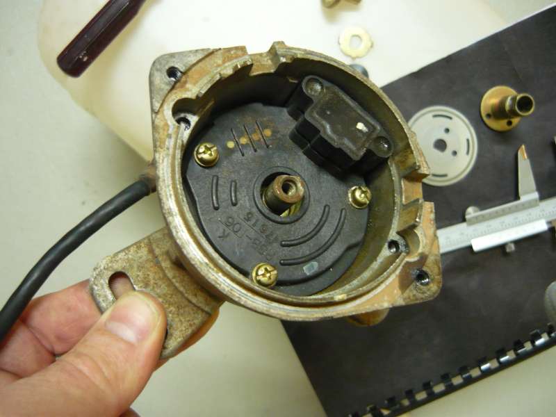

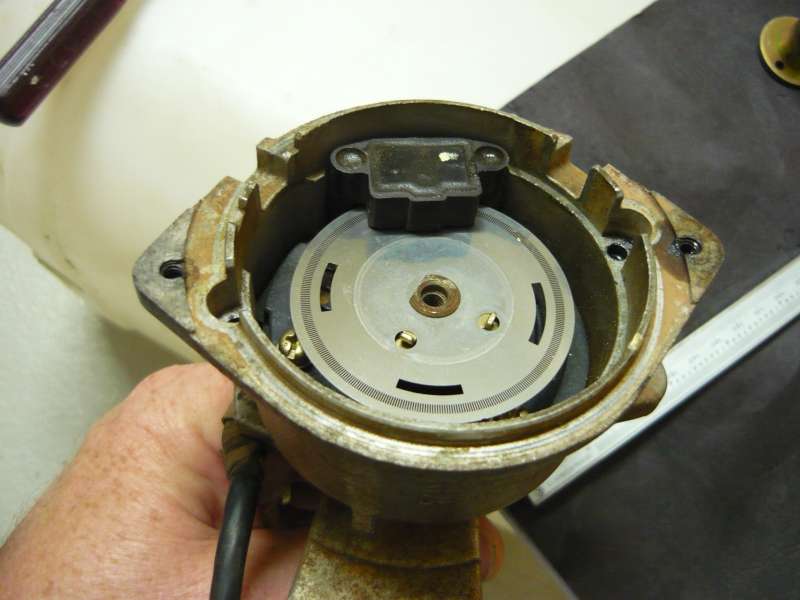

Luckily Subaru used an optical Crank Angle Sensor in the later MPFI L Series and that makes life MUCH easier when setting up a complete engine management system . They are far more accurate that a modified distributor to give the four position and one reference pulse signals to the computer .
Provided the new box has a fast enough processor it can do all the crank position stuff in real time and also give faster more accurate control of large injectors .
I want to have sequential injection because that gives you the say in injection timing as in the injector close point in the 720 degree four stroke cycle .
I want to use injectors large enough not to be a limitation with E85 fuel and that means the ability to hose in something up to nearly 30% more than conventional ULP . I think the largest I'd go would be 440cc and from memory Mazda series 4 or 5 RX7 Turbos used such a thing and I believe some were high resistance ones which suit a ViPec V44 ECU .
Also TPS wise the later 4 plug MPFI EA82's use a potentiometer unit instead of the 3 plug systems twin switch one , they are interchangeable so go bolt .

Are you sure, i thought they had 4 position pulses and 360 position pulses. I was under the impression that there is no pulse to tell the ECU when Cyl No1 TDC is.discopotato03 wrote:Luckily Subaru used an optical Crank Angle Sensor in the later MPFI L Series and that makes life MUCH easier when setting up a complete engine management system . They are far more accurate that a modified distributor to give the four position and one reference pulse signals to the computer .
My guess is that is why they didnt have sequential injection and wasted spark ignition.
I suppose you could always fill in one of the little slots in the CAS dizzy to give your reference.
Disclaimer,... i could be barking up the wrong tree here

Gannon I'm pretty sure those four inner slots are different lengths and thats how the computer knows which cylinder pulse is which .
I don't think Subaru had any intention of running a multi coil system when a single one with rotor and four pole cap distribution system worked well enough .
Also the much tighter ignition timing control makes a big difference to emissions/consumption/drivability .
I'd say with the semi sequential injection they managed to get things clean enough for the 87-89 or whatever year ADR emissions regs . Trust me if they sold them in the US and particularly California our EPA would have been a piece of cake to get past .

PS : Gannon , scroll down through this thread and you'll see pics of a Nissan optical CAS type disc for a six cylinder . Note the inner 6 slots increase in length/arc to differentiate each cylinder .
Basically it would tell the computer which cylinder (in the firing order) is next to TDC rather than waiting till the starter wound the engine round to TDC No 1 to get a reference pulse and start doing the 153624 ting - or 1324 in a flat fours case . Quicker cleaner starting in that oh so cold and dirty first fire up phase .

Adrian sent me the photos of the CAS dizzy

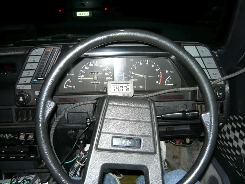

And the Tech Edge wideband AFR display
So is there a difference in the slots to tell the ECU when TDC at cylinder 1 is?
- Tech Edge 1-800.jpg (57.55 KiB) Viewed 10358 times
- CAS 6-800.jpg (34.5 KiB) Viewed 10365 times
- CAS 5-800.jpg (42.46 KiB) Viewed 10365 times
- CAS 3-800.jpg (39.66 KiB) Viewed 10366 times

That aside , Gannon if you look at the optical disc you will notice the top inner curved slot is longer than the other three . The photo diodes output a signal on the rising and falling edges meaning the start and finish of those slots so the computer knows which is longest and representing No 1 cylinder . The third revision of this system , found in Nissan SR20's , has four inner slots of increasing length so , the computer can tell within the quarter of a turn (half a crank revolution) exactly which is the next cylinder approaching TDC at start up . The early version may have to wait nearly a full revolution of the CAS disc before it can find no1 and start counting from there .
