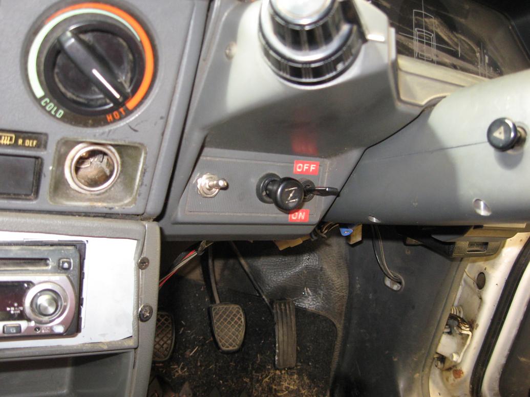

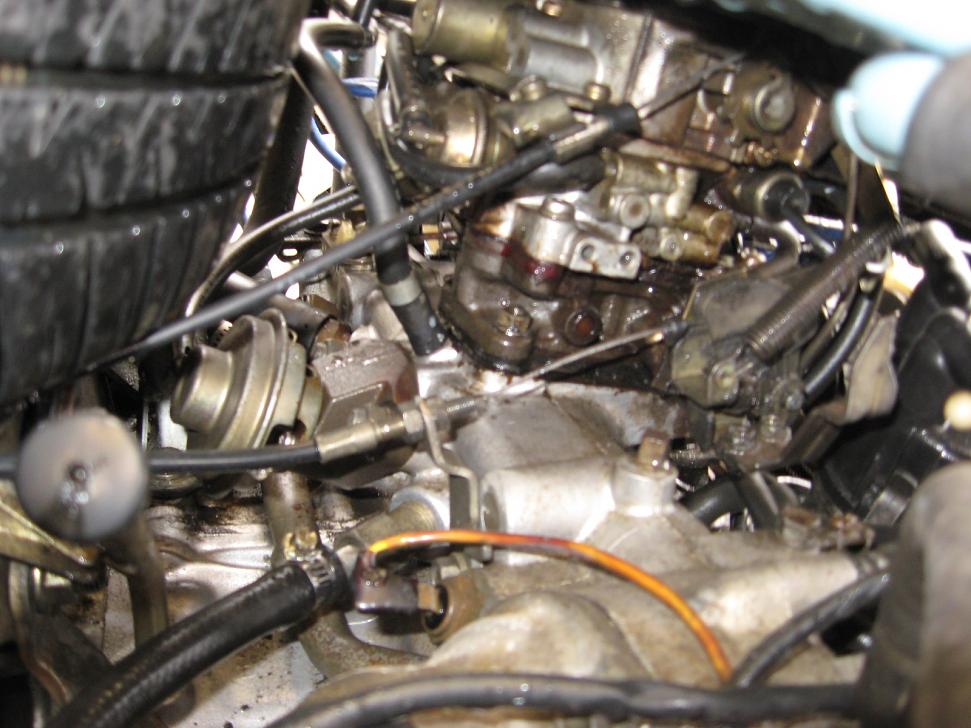

choke
Post by olddog642 » Fri Sep 10, 2010 2:57 pm
Hi there Subiegirl,
here are a couple of pics showing the inside position of the choke control and also a pic of the cable at the carby end, although it is a standard hitachi carby on my 85 Brumby
Hylton :twisted:
