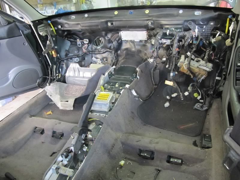

Finished stripping the entire dash on both the outback and halfcut. Massive job this, there is just so many things that need to be dissasembled to get the loom out. Anyway, got it done and reinstalled all the ej20tt loom into the outback.
