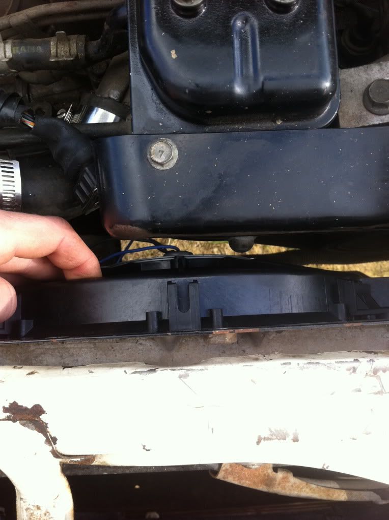

hey mate another quick question have you got the fans in yet??
hows the fit with the 10" fans?? a pic would be great:)

Dann wrote:hey mate another quick question have you got the fans in yet??
Haven't mounted them yet but just holding them on there they seem spot on, ill try get a photo next time im at woody's

Post by stewbaru » Mon May 30, 2011 7:39 pm
Here's a photo of the clearance, its tight but looks closer in the photo than it actually is.

Post by El_Freddo » Thu Jun 02, 2011 12:24 am
stewbaru wrote:Here's a photo of the clearance, its tight but looks closer in the photo than it actually is.
That's pretty good! Mine are closer :???: A three core radiator will do that :rolleyes: I still think that the 3 core is too big for the EJ, I'd love to try out an all copper/brass single core radiator that's setup for the EJ if I had the money... always the way!

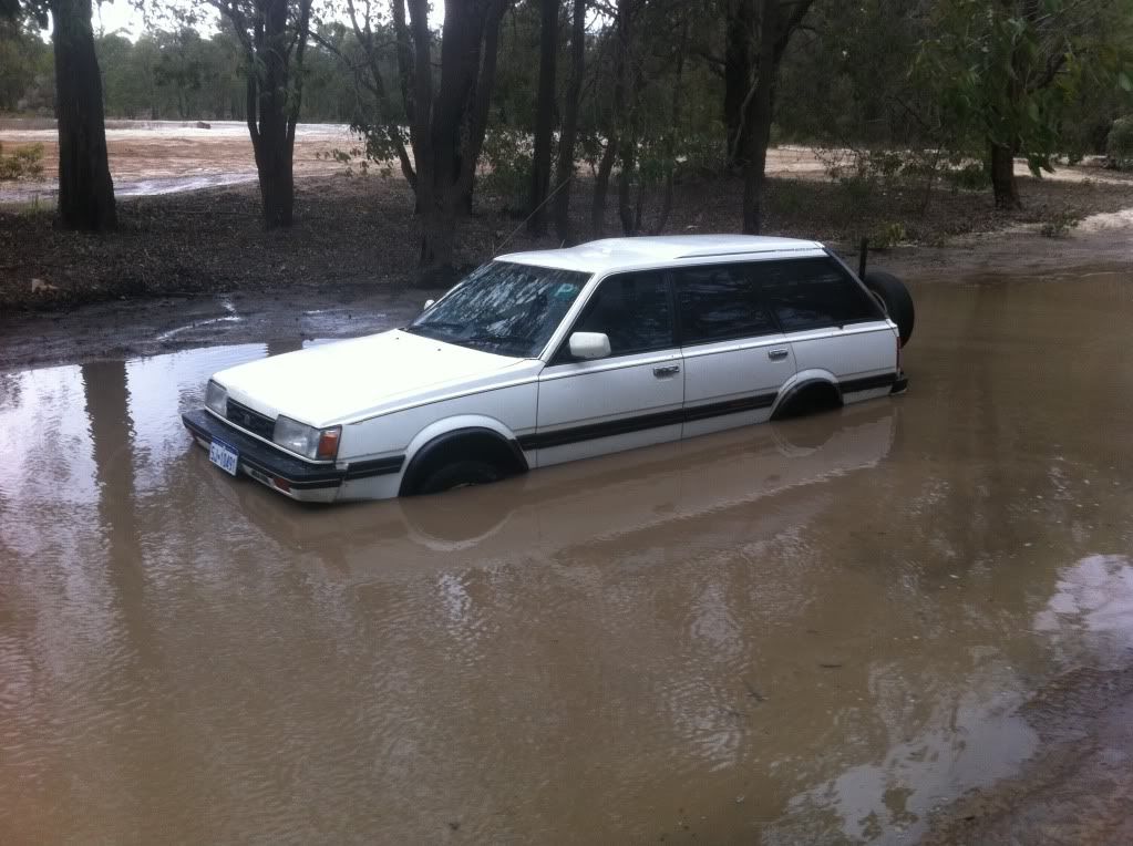

so yeh we took her out for a bit of a play today and i'm not too impressed with nic drowning my phone which was sat in his centre console.. he's got a picture of 2 which he'll post up ..

Post by stewbaru » Sun Jul 10, 2011 8:26 pm
Yeah first off-roading with the ej22 ended with this......
We had gone through a similar puddle to the right and it was reasonably shallow so didnt bother checking the next one, and turns out there was a massive ditch in the middle of that one haha all good though the interior is soaked but thankfully it wasn't deep enough to get water in the intake

Post by woody.t » Sun Jul 10, 2011 8:29 pm
only one to get out of the car with a working phone, lucky you.
