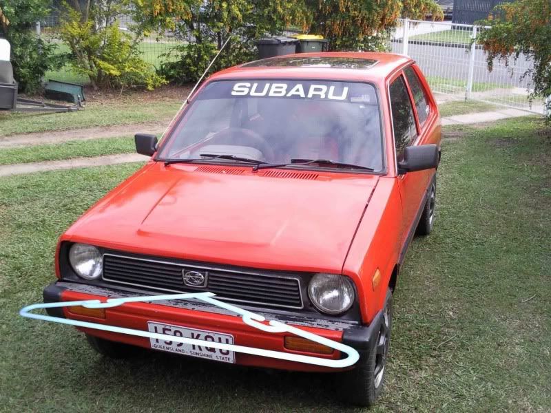

Suparoo wrote:Bend a coat-hanger into a bullbar shape, then use some double-sided tape and stick it to the bumper. It should be nearly big enough to protect the entire front end :)
just thought id see what it would look like. lol
