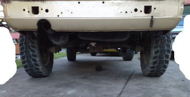

thoughts would be more usefull if i had more time to do what i want... gonna be cuttin the guards more later on when i can afford new "big" tyres...

how much did the front wheels move forward, i can sense some larger than 27's being able to fit in there now...
27's without more cutting, but 30's needs more front n some rear cutting...
bout 4-5 inches forward and 2 out, the front moved...

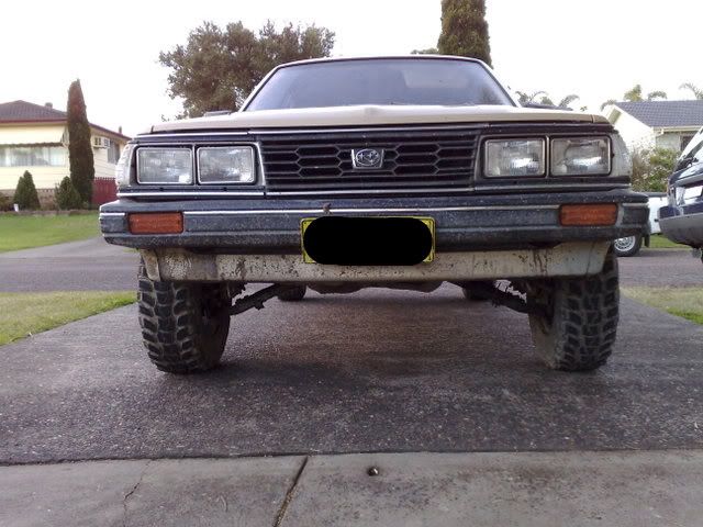

been cruizin around a bit, seems to handle like a gokart, shiteloads of camber untill i can sort out new front suspension to level the front out a bit... rear at lowest = 2" higher than front at highest.... lol... thinkin either coil over sleve kit n longer inserts or longer inserts with "airbag" above or below current spring...:P

2coupedup wrote:seems to handle like a gokart,
and looks like a dirt buggy!! damn front camber! haha nice clearances though...

heaps of negative damber... and with standard strut tops, need longer front suspension to compensate.... gotta sort out some kinda adjuastable strut tops and better height adjustment...

Tyres On Lift Kit Out
Post by 2coupedup » Sun Jul 06, 2008 5:21 pm
removed lift kit (had way to much negative camber)
and put my pretty muddies on hehe...
and plenty of clearance
