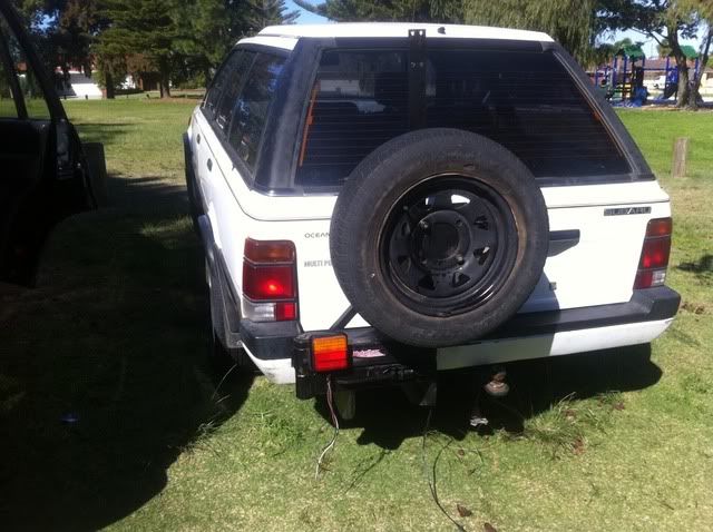

:):):):):):) Anyone recognise this? Haha
Post by RSR 555 » Tue May 10, 2011 2:22 pm
stewbaru wrote::):):):):):) Anyone recognise this? Haha
Yep.. looks like the one that used to way the back end of a grey Touring Wagon down :cool:
Dann
Posts: 232
Post by Dann » Tue May 10, 2011 2:45 pm
And before the grey wagon it was on a white wagon:)
Dann
Looking for:
- LSD diff
Post by Alex » Tue May 10, 2011 3:18 pm
and before that it was on a beige MY wagon :P
curiousity, do all the LEDs still work in that light? I payed a bucket for that thing haha
stewbaru
Posts: 49
Joined: Sat Nov 27, 2010 11:55 pm
Post by stewbaru » Tue May 10, 2011 4:33 pm
Haha top marks for everyone
Alex wrote:and before that it was on a beige MY wagon :P
Not to sure actually, ill check them next time i'm at woody's
Post by guyph_01 » Tue May 10, 2011 4:44 pm
Yeah they all worked last time I checked:)
The back end of the grey wagon looks weird now, Oh and there's a huge noticeable canon exhaust that's sticking on the side LOL!

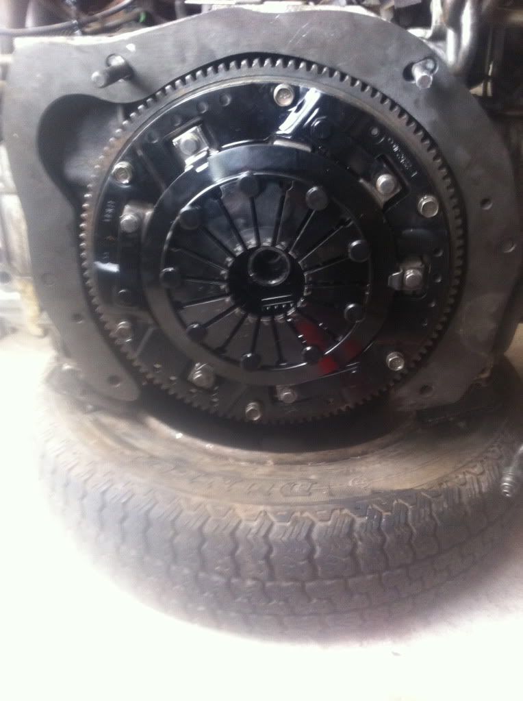

Just got the clutch back today, quality job by scott. However the adapter plate and bolts are not quite lining up.
Heres a photo of the situation at present
Anybody got any ideas as to why it wont go on? Thinking about drilling the top gearbox holes out slightly but its a bit dodgy....

Post by guyph_01 » Sun May 15, 2011 8:05 pm
You should have bought my Adaptor plate, 3 very happy clients:P Lol
But seriously, you should grind off the plate where its close to the flywheel and allow about 2mm gap. You can also drill the bolt holes wider, no issues there. Just as long as the stud holes are tight enough.

Post by stewbaru » Sun May 15, 2011 8:21 pm
Haha ill have to take it back to the seller then ;)
Ended up snapping one of the welds on those bolts anyway :( a painful day with not much progress at all
Post by RSR 555 » Mon May 16, 2011 4:08 am
Yeah.. I'd take that adapter plate back !! Dodgy bastards :D
I did have similar troubles with Glen's conversion and we just opened up the holes slightly on the gearbox. Don't see it being dodgy as long as the dowels are in place, everything will be lined up correctly.
I had 20 of these adapter plates made up and only have 3 left. Yours and Glen's are the only ones that have had this problem??
btw.. you must have put some serious force on them bolt :???:

Post by stewbaru » Mon May 16, 2011 2:39 pm
RSR 555 wrote:Yeah.. I'd take that adapter plate back !! Dodgy bastards :D
Hmm I'll have to give it another go after uni today. The dowels and bottom bolts were fine so should be sweet.

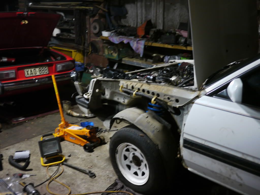

showing off the shiny blue springs ;) Image
engine finally in it's new home

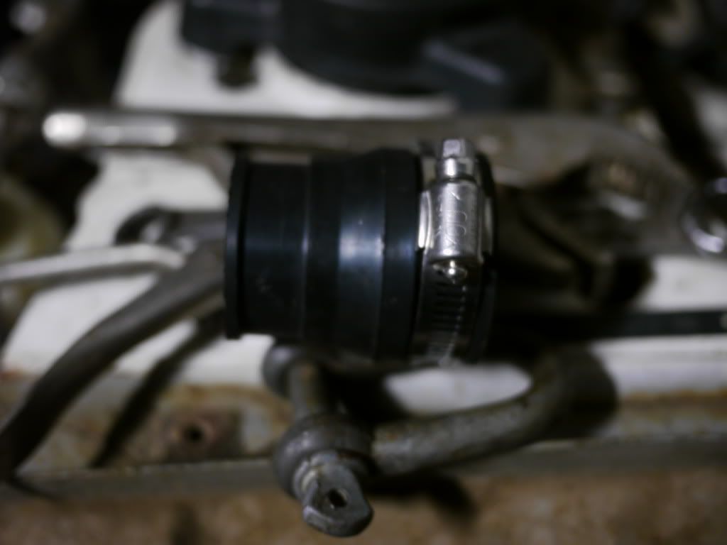

hose adapter worked out to be perfect size for ej to ea radiator hoses... not sure how well it will hold but once the engine is in, wired up and running it's coming straight back out to put ej radiator and after market mounts in and fix one or two other things... ran out of time to get hold of them and or put in before the weekend when we'd tee-d subarino up so just do it after..

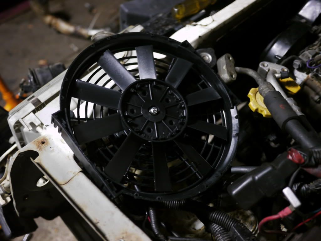

after market fans which nic had to sell his kidney to purchase, he's not a big drinker so with careful thought he wont miss it anyway

what size are those fans?? 2 or 1 of them??

Post by woody.t » Sat May 21, 2011 12:47 pm
2 x 10" from supercheap

Post by El_Freddo » Tue May 24, 2011 12:27 pm
woody.t wrote:2 x 10" from supercheap
I got mine on fleabay - about $30 each plus postage, except I got one 9 inch and two 7 inch to fit between the radiator and the EJ. I reckon I'd go 2x 9 inch if I was to do it again as they're 5-7mm thinner and pull a pot load more air than the 7's do. Either way I can now drag some serious heat from the radiator :twisted:

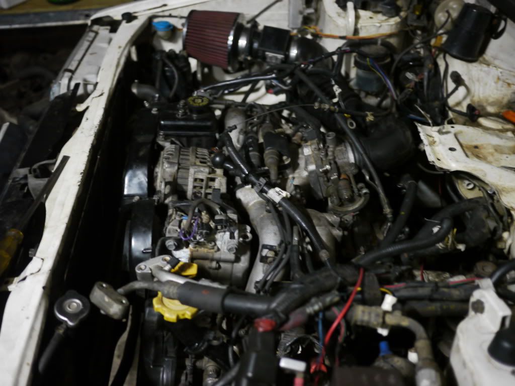

Post by stewbaru » Wed May 25, 2011 2:10 pm
Haha yeah well thanks to dave's handywork we got her running, it was running a bit rough though and we found that the injectors on cylinders 3 and 4 aren't working properly so have to get them serviced.
But since then i've been lazy and the dash is still out, hopefully attack a bit of that this afternoon. Then we need to adapt the bottom rad hose, the l series heater pipes dont reach so hoping liberty ones will? missing a few vacuum pipes aswell so get them sorted then give her a good service.

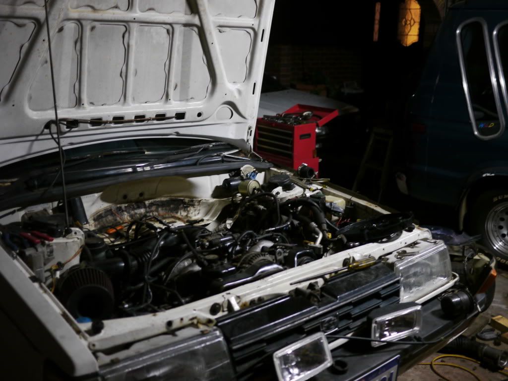

Post by woody.t » Wed May 25, 2011 7:00 pm

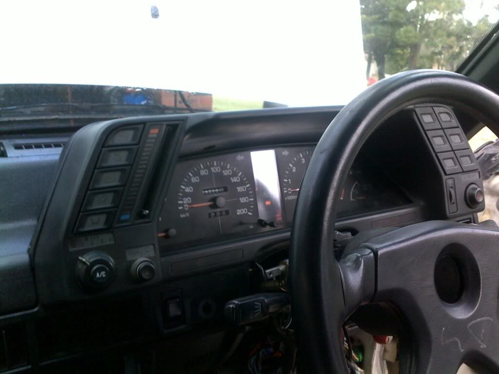

spent a bit of time after uni today dash is back in and everything is working as far as we can tell....
to do list:
Post by guyph_01 » Wed May 25, 2011 8:33 pm
Nice RS wheel:) let us know how well the black painted dash holds up:)
there's gonna be quite a few freshly converted ej powered L in WA that would soon be ready for some great trips:p can't wait...
