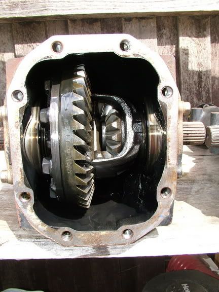

And as for the diff protector - you can put it on your current diff, it is detachable from the diff you've photographed. The trick to working out the diff ratio is to mark a tooth through the top oil fill hole - then count the teeth - 39 teeth = 3.9 ratio, 37 teeth = 3.7 ratio diff... Pretty easy.

easy way knowing if you have LSD is jack both rear wheels off the ground, turn one wheel around and look on other side - if both turns at same direction then you're likely to have LSD, if it turns opposite way then its open diff....guyph_01 wrote:ok cool.

Here is a picture of open diff
Here is a picture of VLSD from RS Liberty.
