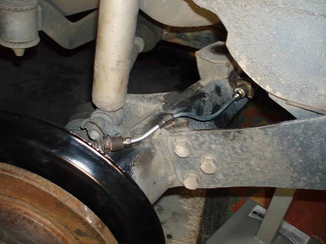

So, how does one get the RX brake lines onto the Brumby? Neither line seems suitable... are you guys getting someone to custom make you lines?
Toonga seems to have a line that fits and sits in the brace on his thread but neither my old or new line looks like the one he fitted...
Post by TOONGA » Sat Dec 31, 2011 4:34 pm
All I did was reshape the "L" metal lines to fit up to the rubber lines that were on my calipers.
Post by steptoe » Sat Dec 31, 2011 4:40 pm
I just reshaped mine, but take care not to bend within an inch of the ends with the fitting and do 'em up loosish by hand before any spanners. It wasn't an easy as thing to do, though never lost any sleep over it after the same level of panic you seem to be in. Funny how no one mentions this tricky little procedure. Mine are no longer secured to the arm bracket.
Note how on an L series they have a hole in the end of the swing arm between the two bolts that I think the hose may fit on L. The MY does not have same hole.

Post by 555Ron » Wed Jan 04, 2012 5:09 pm
I ended up buying some new brake lines and bending them as i kinked the old ones when bending.
Only then did i realise i had a pipe cutter and flaring kit for brake lines in the shed. But they turned out pretty good... Expensive though:cool:
