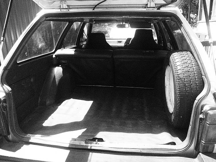

nothing much new. I made up a bracket for the spare wheel a while ago, which sits nicely in the back. i dont want a rear carrier and apart from being annoying i think its dangerous just put behind a front seat.
this is the finished product (sorry about the b/w pics):
[ATTACH]3639[/ATTACH]
[ATTACH]3640[/ATTACH]
probably not the most popular option on here, but i like it. secure and out of the way. looks fine as well, minimal cutting to the inside panel, but you cant see it with the wheel in the way anyway. i only have the 13 as a spare, it fits in well.
Post by RSR 555 » Sat Oct 27, 2012 11:22 pm
Cool Rob.. I like it :)
I'm more for putting it outside so you can have more space for camping gear

Post by MTB92 » Sun Oct 28, 2012 12:05 am
RSR 555 wrote:Cool Rob.. I like it :)
cheers Paul :)
yeh, i think most people here will agree with that. most of my camping is with only 2 people and a couple of mountain bikes in the back, so find an extra obstacle to get to the boot a pain. I can still fit 2 assembled bikes + a couple of swags to seperate them and all bike + camping equipment in the back no worries.
plus the extra weight of a rear bumper + arms, relocating number plate and redoing lights and indicators it was just easier to throw it on the inside for me. i dont think most people will find it best this way.
Post by El_Freddo » Fri Nov 02, 2012 9:40 pm
There's also a captive nut in the floor near the LHS guard that will bolt a 27 inch tyre - all you need to do is find an appropriate bolt. I've used mine a few times.
