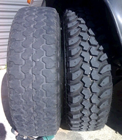

Hey Brumbyrunner, did you notice the Hankook RT01's on the Ranger. They are the same style as I just put on the L. I'm pretty certain that's what they are from the pics. Tread blocks are identical.

Tyres
I've been running between the computer and the car comparing the pic and I'm pretty sure they are the same. Have another look at the pic below
