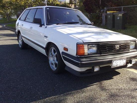

front mount vs top mount
Post by buddah » Tue Oct 14, 2008 10:00 pm
I'm sure this thread has been started before.
However I'm currently looking in to installing a larger intercooler in my EJ20T converted 84 wagon.
It currently has the original small water intercooler setup that it got form the 91 rs it came from. But I'm looking to keep it cooler and hopefully gain a few kw's at the wheels.
I was wondering what people thought the best thing would be?
With the top mount;
pros-
It bolts on nice an close so you would think there would be less lag than with all the piping to the front.
Easier to install.
Nice scoop on the bonnet
cons-
There's obviously a limit to the size.
Nice big scoop that says "hello mr policeman I have a turbo".
What do people reckon?

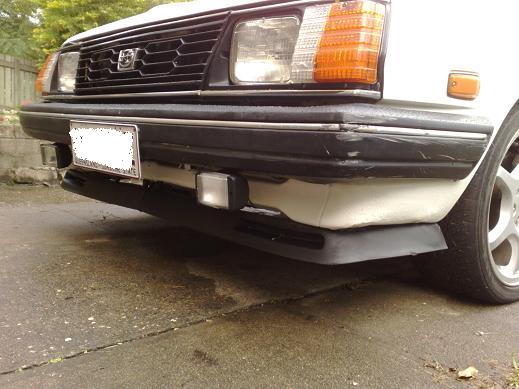

Post by buddah » Wed Oct 15, 2008 7:41 pm
El_Freddo wrote:A larger radiator as suggested by W.L.Rex and a thermo fan operated by a manual switch when needed/wanted to draw air through this radiator.
If I was to keep the current WAIC system and upgrade the radiator, It would have to go in the space where I would probably put a FMIC ( behind the bumper and sticking out underneath). As the current one only just squeezes in behind the grill.
If I did this, and then was to upgrade injectors, turbo, extractors ( which I hope to do eventually ). Would the current WAIC system with a larger radiator be sufficient?
