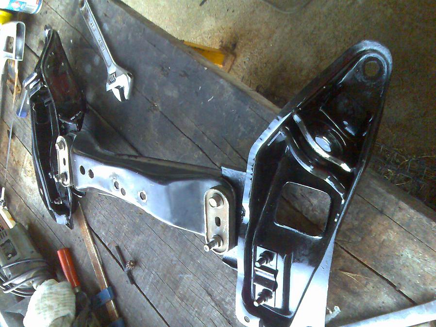

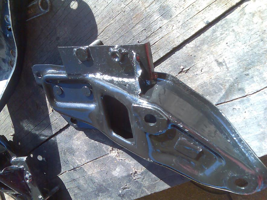

just wanted to share some info back cauce of all i have learnt from this site, so have had a go at attaching pics of how i did the gbox member for my brumby. i utilised part of a wrx/liberty member and redrilled to fit onto gbox rubber isolators. then burred out the end holes to suit the other isolators that wrx/libs use. finally welding sume cut down rhs onto underbody pieces, and tacking bolts and nuts on top.
gearbox is low enough for shifter to clear tailshaft too.
