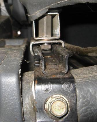

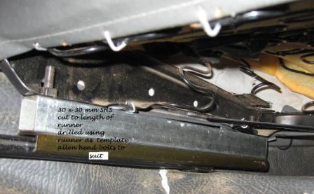

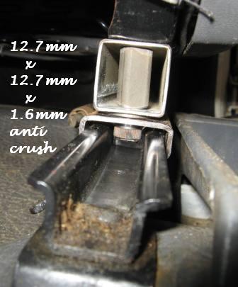

This is what I did to my seat as it was low.
I fitted a section of 30x30 SHS to the runners.
I cut the SHS to lenght and used the runner as a template to drill the holes
and I also used 12.5x12.5x1.6 SHS as compression tubes.
the longer bolts required to fit it all back together I used allen head bolts,
but any bolt of sufficient strenght grade and head to fit in the slide will do.
Hylton:twisted:

Thanks Hylton, I was just thinking about what I could do while I was walking the dog :rolleyes: Came up with pretty much the same solution, do you know what thread size the original bolts are? would just make life a bit easier if the new bolts went straight in.
Cheers!

Post by olddog642 » Sat Feb 19, 2011 8:38 pm
Cheers![/QUOTE]
Not sure but I'll go and check as soon as I finish my dinner but I somehow think that they are 8mm with a 1.25 pitch but will check
Hylton:twisted:
olddog642
Posts: 355
Location: Scullin / ACT
Bolts
Post by olddog642 » Sat Feb 19, 2011 9:03 pm
Yep the size is 8mm x 125 pitch the ones I used are 50mm long allen head
Hylton:twisted:
Ps if you are satified with the seat height after you add the riser just use a mig and run a couple of welds to the runner then give it a coat of paint. Use about a 2mm wall thickness SHS
