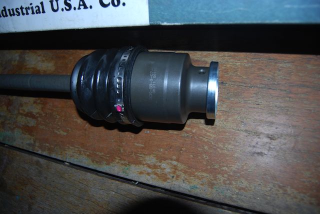

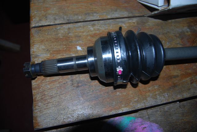

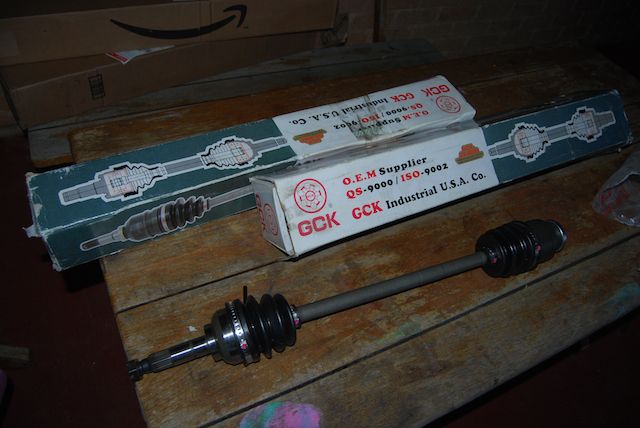

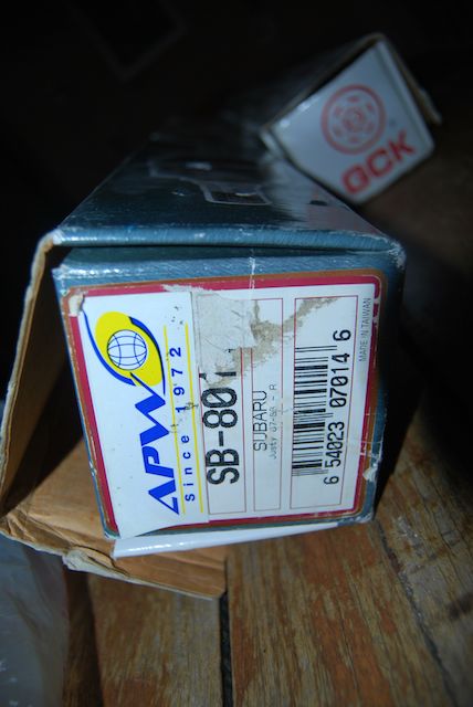

I bought a pair of "Brumby" driveshafts from Amazon for $15 each plus postage ~$40 in total (yes $15 each for last 2!). One has arrived but it's labelled for Justy 87-88 R. Now I've had a look at Justy's online and am not sure this will fit. Any ideas? I haven't crawled underneath the see. Well if they don't fit, I will have a nice set of Justy driveshafts for sale to anyone "lucky" enough to own one. These are labelled GCK Industrial USA Made in Taiwan.

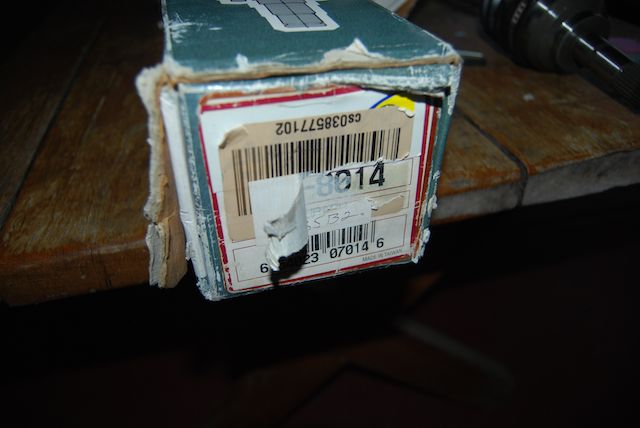

The shafts are labelled SB-8014 (APW since 1972). They are coded GCK-SB-1-07-013 (outer male), GCK-SB-8-07-014 (axle), GCK-SB-3-07-516 (inner female) and bar-coded 6_54023-07014-6 (CS 038577102). Google searches inconclusive. One says Justy only, not Brumby/Brat; another says 2002-4 Impreza! Is there anyone close to Geraldton who may have a Brumby shaft to compare these with?

Jutsy drive shafts probably won't fit - 99.9% sure on that one.
