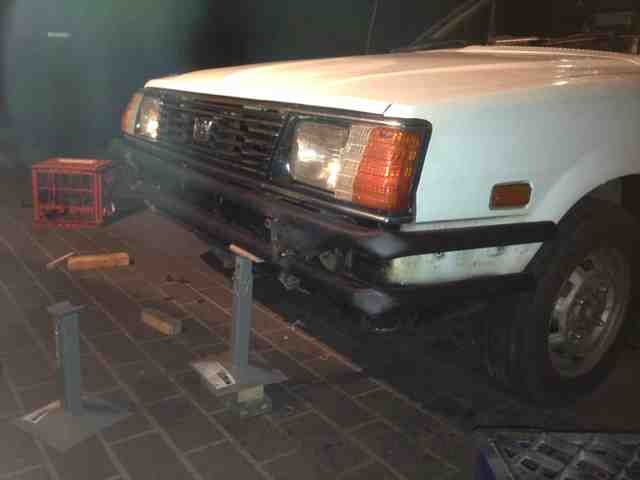

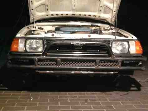

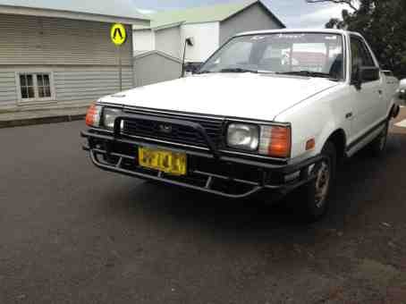

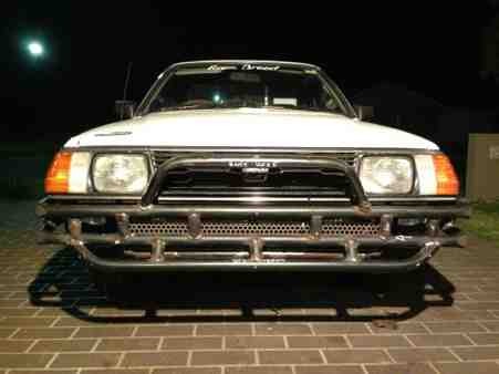

After coming close to cleaning up several Roos and a wombat last weekend I thought It was time to upgrade from the useless hoop style aluminium bar on the brumby.
So during the week over a few nights I pugged away and made myself a steel tube bar that should be solid enough to clean up anything short of an ox.
Some photos of the progress and the finished product

That sounds pretty good to me. That's the weight of a spare wheel, or a jerry can or a case of beer. Nothing to worry about.MuZ wrote:Dead on 30kg, only 16 kgs heavier than the bumper and Ali bar that came off it. Ill be keeping track of my fuel economy for the next few weeks to see if there's a noticeable difference

Hit a roo with the driver's side of mine years ago with the tube bar and it pressed the bar back into the bumper and sort of crushed it in, they aren't the best

I had the same problem with the tube bar on the old hilux I had, I think this one should be fine though, the tube has a 3.6mm wall thickness and the corners are all braced with gussets. Either way it's gonna be stronger than the Ali oneT.Farm.Brumby wrote:Looks good
