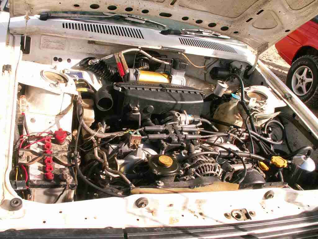

Hi Guys,
time to get rid of the pod filter i currently have and plumb in a proper airbox for my motor.
any suggestions on what others have would be great and any other things that may be relevant.
basically i want an airbox that can sit up in the spare wheel holder in the brumby engine bay, and i want a round inlet and outlet, for future hookup of snorkel etc.
Thanks in advance for replys
Cheers Tim

Post by vincentvega » Thu May 01, 2008 6:12 pm
I have seen a MPFI L series air box fitted in a brumby engine bay. looked a good fit

Tim82
Posts: 83
Post by Tim82 » Fri May 02, 2008 12:35 pm
Thanks for that last pic, it looks exactly like the kind of thing i want.
now ive got to go and find one!!
Cheers Tim

Tim82
Posts: 83
Post by Tim82 » Fri May 02, 2008 12:38 pm
quick question about that pic.
where is the air flow meter meant to go? is it just removed in that pic?
Cheers Tim
91 Brumby
Lift, Tyres, EJ, plus more...

Post by Cam » Fri May 02, 2008 1:39 pm
Afm's in the throttle body...

Post by Tim82 » Fri May 02, 2008 1:49 pm
so i would have to mount my afm in between the throttle body and air filter then. engine is 96 EJ22 with a seperate afm
Cheers Tim

Post by daza » Fri May 02, 2008 3:24 pm
Tim82 wrote:so i would have to mount my afm in between the throttle body and air filter then. engine is 96 EJ22 with a seperate afm
Yep,
some short bits of 3" hose and the filter could sit rite up on the spare wheel carrier.

Post by Dane » Tue Jun 02, 2009 6:52 pm
Any progress on this one? Did you run in the vacuum lines? Anybody's opinion on how the engine would run minus the vacuum hoses in the intake?

I'll take some shots of mine, it is from a mitsubishi magna, sits at the front on the drivers side, draws air from just behind the headlights. Pics to come when i get home.
