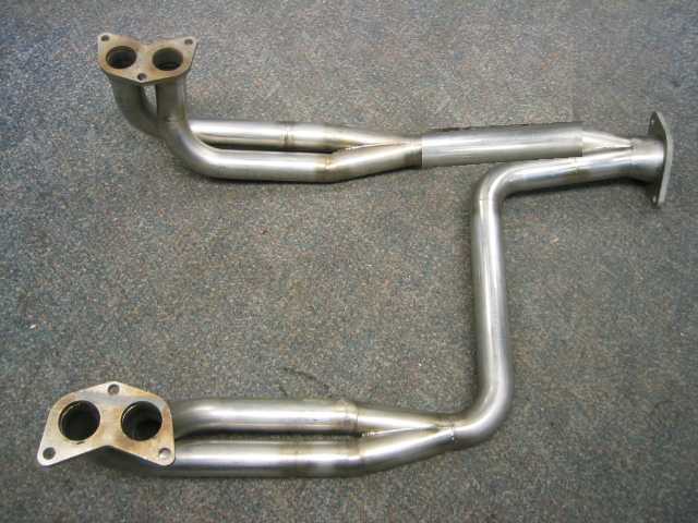

If i were to make my own, i would buy 4 mandrel 1-3/4" bends and make my own, and replaced the silly shaped factory cat.
Something similar to this design, but without the silly hump, in 4-2-1 (over the 4 into 1) design cos its more suited to everyday driving (so i was told)
But then a little voice in my heads says, shouldnt you join cylinders 1 & 2, and 3 & 4 in the primaries like they do on other 4 cylinder engines
Some EJ turbo manifolds do this, but no NA ones. Probably cos its too hard to package.

I have a set of the first pic of the headers on my EJ22. They work very well they give a massive torque increase.
That design is proably the best setup. Rember you motor is now NA not turbo charged. The exhaust headers dont need to be 'fancy'

Im thinking of making my own based on the design of the 2nd pic. If im gonna do the headers, i wanna also get rid of that funny shaped cat converter
I just need to get hold of some EJ exhaust/head flanges and 4x 1-3/4" mandrel bends
Post by AlpineRaven » Mon Jul 13, 2009 9:57 pm
The "Hump" in the 2nd picture would have been that idea to make the same length for left and right bank to give it even power output...
In the 3rd Picture - wouldnt make any difference from picture one and 2, because of the way the engine works - while the cylinder is under compression the other cylinder will exhaust so it works both ways as close and open in both cylinders on each bank - that what i think?

Yeah , it can be hard to have a bang for buck win with non stand exhaust headers . The thing is that the state of tune of the engine is designed around the exhaust flow characteristics of the std exhaust - from heads to chrome tip . One you start to change things you get into a grey area unless you know exactly what the factory got from their std setup .
In a perfect world you'd be able to mimic their systems positives and improve upon any negative compromises .
Probably the hardest thing to do is to decide on tube diameter and primary length . Both of these affect how well the engine breathes out and how well the header system allows the cylinders to scavenge at the valve overlap phase .
Really to get an insight you'd need to dyno the engine so you have an idea of its torque characteristics - as in where the factory intends it to be .
Its pointless trying to enhance upper rev range breathing if the engine is designed to pull from low revs which most are nowdays .
This is often why less than adequate , small enough , tube sizes are used because people don't understand how to make torque at user friendly revs .
As for how to get the correct cylinders linked .
In a nutshell you want to have all the exhausts putts or exhaust events evenly spaced and Subaru don't normally do it like that . What they do is link the exhaust ports on each head together because its cost effective and packaging wise the way to go .
Now because Fuji's flat fours fire the adjacent cylinders in each side or bank before crossing to the other pair two exhaust events are close together followed by a pause then over to the other side or pair .
This not to say that you don't get evenly spaced power strokes , it is to say that these engines operate more like two in line twins sharing a common crankshaft .
From a strictly functional engineering point of view the front two cylinders and the rear two cylinders should be linked , but Subaru only do this on their twin scroll turbocharged flat fours . The single scroll turbo engines get the same crap system as the NA fours .

Im going to get 4 x 1-5/8" bends, 2 x 2inch bends and 3 collectors from the zorst shop, make up some flanges and see how i go.
Basic design will be 4 x 1-5/8 inch primaries about 400-500mm long(the exhaust ports in the heads are 1-1/2 inch) that feed into 2 x 2inch secondaries that feed into a 2-1/4" collector just before a high flow cat. It will then join to the existing exhaust system just before the second cat with a length of 2-1/4" pipe.
I'll take a picture of a mock up of how im gonna do it.
I will be concentrating on good flowing bends and merges rather than equal length for now.
Post by steptoe » Sun Aug 02, 2009 11:46 am
and while you are there I wonder if an old turbo from your pile of spares might just team up with your mandrel bends, check out where the oil feed will come from..... :)
Post by Gannon » Sun Aug 02, 2009 5:41 pm
This is the design im aiming for
The primaries will be equal length, but the secondaries wont be. This isnt a concern because im not matching the right ports to make full use of scavenging anyway.

Post by Gannon » Mon Aug 03, 2009 4:35 pm
Would that be these?
Here are an aftermarket set that are of the same concept (but are made with mandrel bends and no pre-turbo cat)
