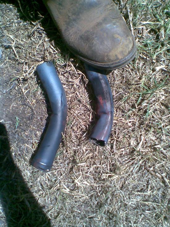

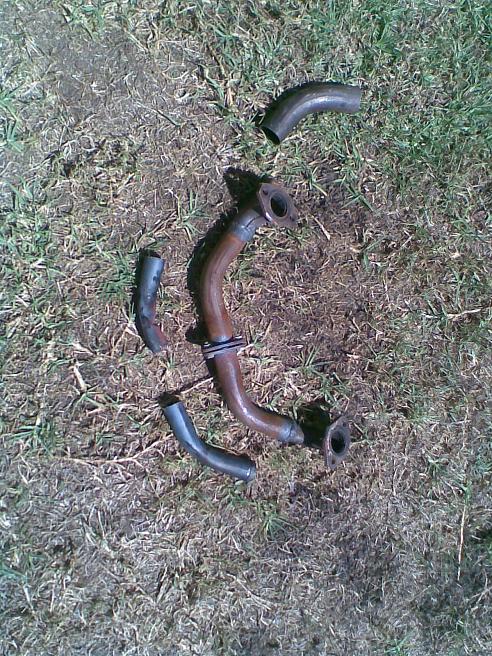

Dad and I borrowed the tractor off the guy i sold my car to, and while we were there, we got talking about my car and the guy showed me the new crossover pipe he was constructing.

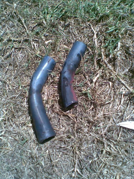

He dismantled the factory crossover pipe to see what was inside and was disgusted, the crossover pipe is made up of one pipe inside the other, but to make it, the simply slid the smaller one inside the larger one and then crush bent them together.
The photos show the awful bend of the inner pipe inside the crossover pipe
The pipe on the right has a less than 20mm x 30mm oval gap (its smaller than the siamese port in the head) for the exhaust gasses to flow through. The T Join under head 1/3 is the best flowing part of the whole manifold.
This is the new one he is making, out of all 3/4" pipe, but is keeping the stock 2/4 side bend, and the 1/3 side T join. With a bit of porting with a dremel, they dont look to bad.
He has put a flange in the middle to make it easier to remove the pipe once in the car. There will also be a flange between the 1/3 head and the turbo, so the manifold can be broken down to 3 separate parts

It doesn't look real flash inside the crossover pipe but having the pipe lengths so different makes things awkward .
I think if he tries to have all the diameters the same meaning the port end bends and crossover it may create problems .
It's possible see what they tried to achieve with the std header and always remember that they don't make allowances for extra performance down the road from the showroom .
I like the idea of the TWE design and I get the feeling that they get away with (to a degree) slightly larger pipe diameters because the engine pipes merge just before the turbo rather than into a single up pipe .
The problem is that its difficult to get the two pipes up through the crossmember (or whatever) and things like power steering hard lines get a bit close and probably hot as well .
Having extra joints in the system is a good idea and the most compact way to do the fasteners would be to thread the flange plates on one side and use high tensile cap screws from the other side .
