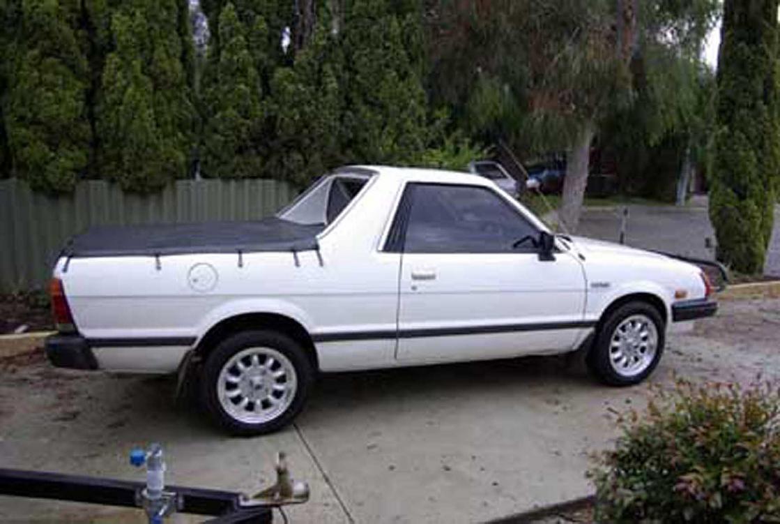

I ended up getting Speedy wheels. 15inch fitted with 185's. Don't do any off road stuff but they come in 5.5, 6 or 7inch series.
Photo attached.

Post by red_rocket » Sun May 23, 2010 11:33 pm
they look pretty good i reckon. how much for the set?

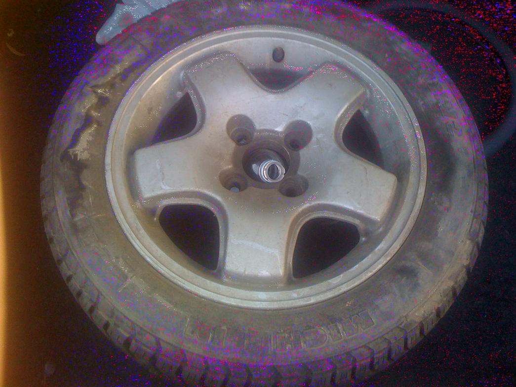

Post by tex » Mon May 24, 2010 10:25 am
Don't disregard Peugeot rims they have some nice 15" aftermarket rims just avoid the ones with the european sizes so wary of any of the ones with michelins on them!

Post by RSR 555 » Mon May 24, 2010 11:01 am
tex wrote:Don't disregard Peugeot rims they have some nice 15" aftermarket rims just avoid the ones with the european sizes so wary of any of the ones with michelins on them!
That doesn't look like the Subaru 4 stud pattern :confused:

Post by Tozzy » Mon May 24, 2010 7:18 pm
My wheels are through a tyre guy in Mandurah but can get them from any tyre place. They are "Speedy Wheels" & made special in S.A. I believe. Took me about 3 months to get them because of the 140mm stud pattern. Wasn't in a hurry as I had the ute stripped down anyway. Cost was a bit much, around 1200bucks. I had the tyres from a friends new Suzuki Swift. She got mags put on and kept the wheels.
