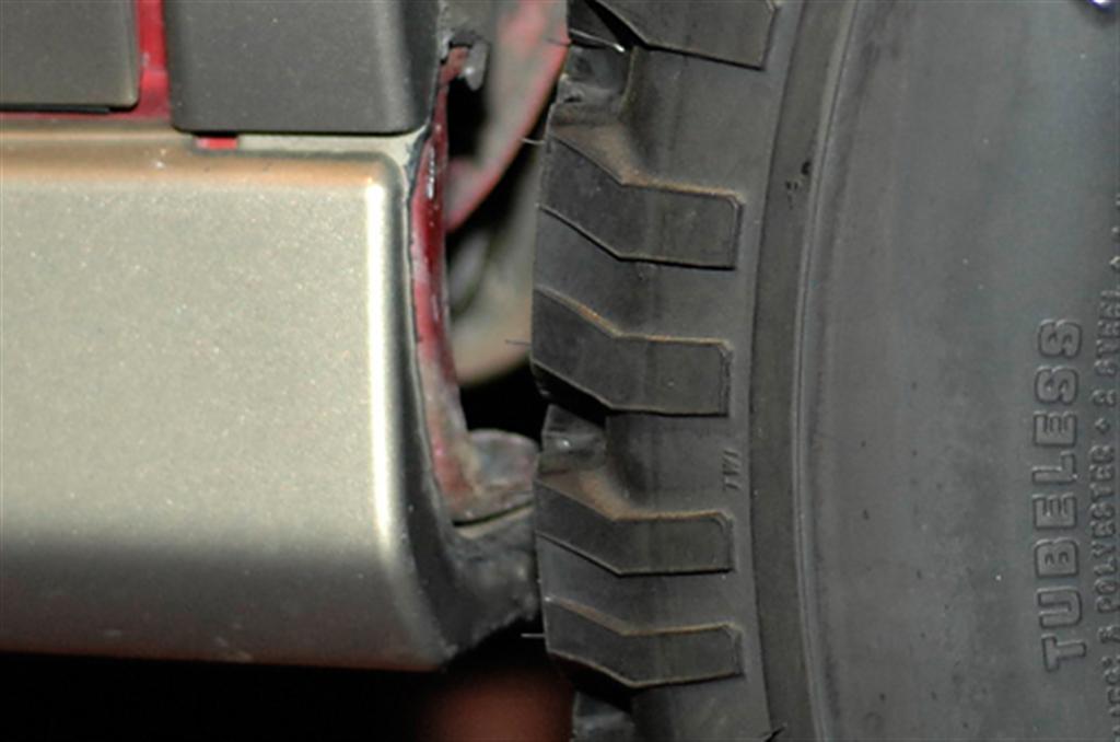

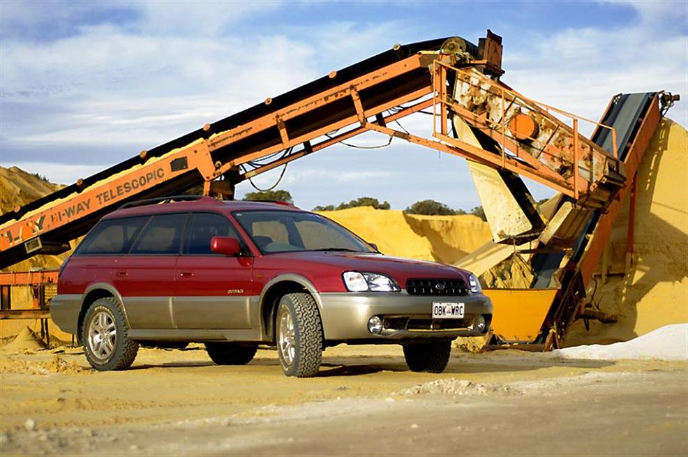

Just remembered seeing a gen3 with the tyres you mentioned.It wasn't lifted but it had the guards trimmed

I have the same tyres on my standard Gen 3 OB,they only rub at the back on full compression with a heavy load in the car and then only just. I am about to fit raised king springs which should eliminate this. They will put the speedo out by around 10%, but are a great tyre on gravel.

Only the rear tyres rub and only on the trim inside the guard when the suspension is fully compresses so no drama.
