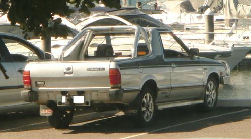

Hey Guys, have a 1986 twin headlight targa top brumby with 1994 WRX EJ20 Turbo and WRX dash fitted :D. Heaps of thanks to the site for providing information / advice on the conversion allowing me to complete the work.

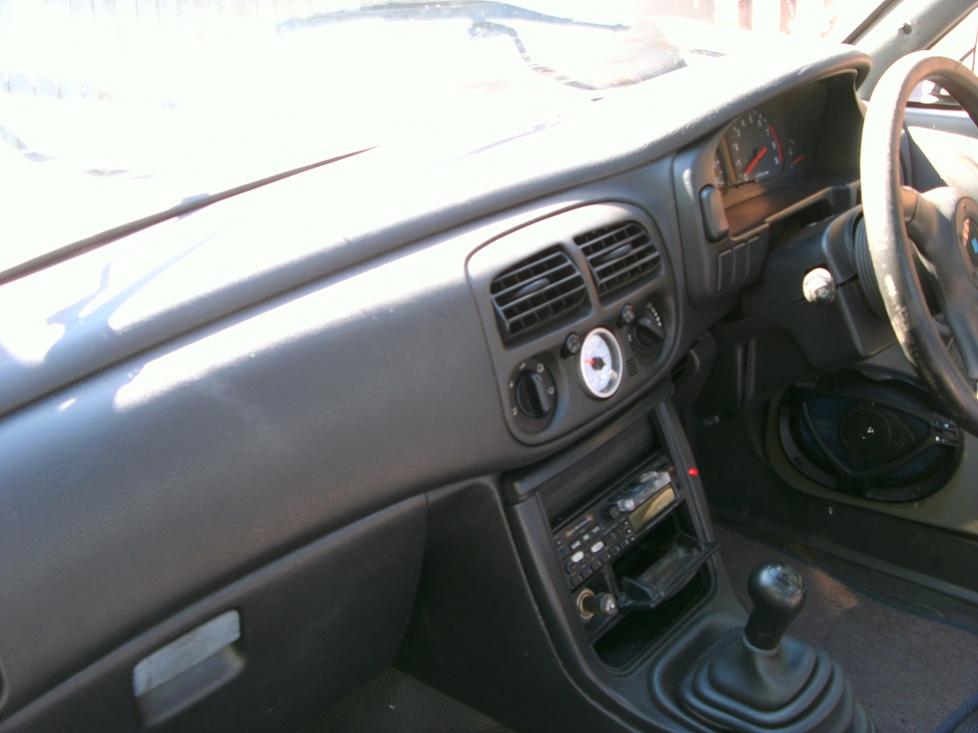

awesome. I so want a brumby with a wrx dash!
what was involved in getting the dash to fit? Do you have any pictures?

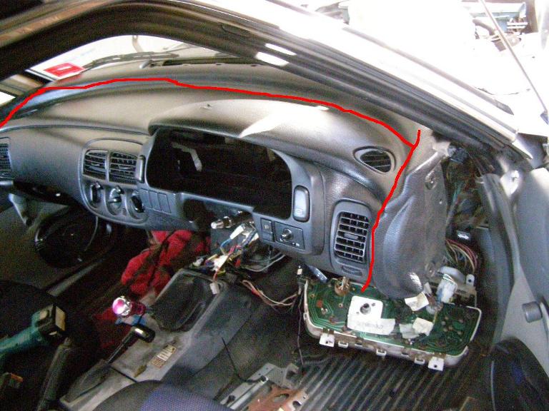

Post by brute » Tue Jun 30, 2009 2:47 pm
Fair bit of time, sacrifice to heating, air conditioning and glovebox. The WRX dash is wider and physically deeper so lots of chopping to get it in. Made an aluminium bracket to mount dash against the firewall and some extra supports on either side.
The Dash image shows in red where about chopping was required.
Still needs some tidying up, boost guage fits nicely where the AC / Heater control once was.

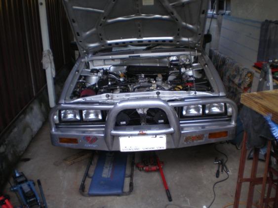

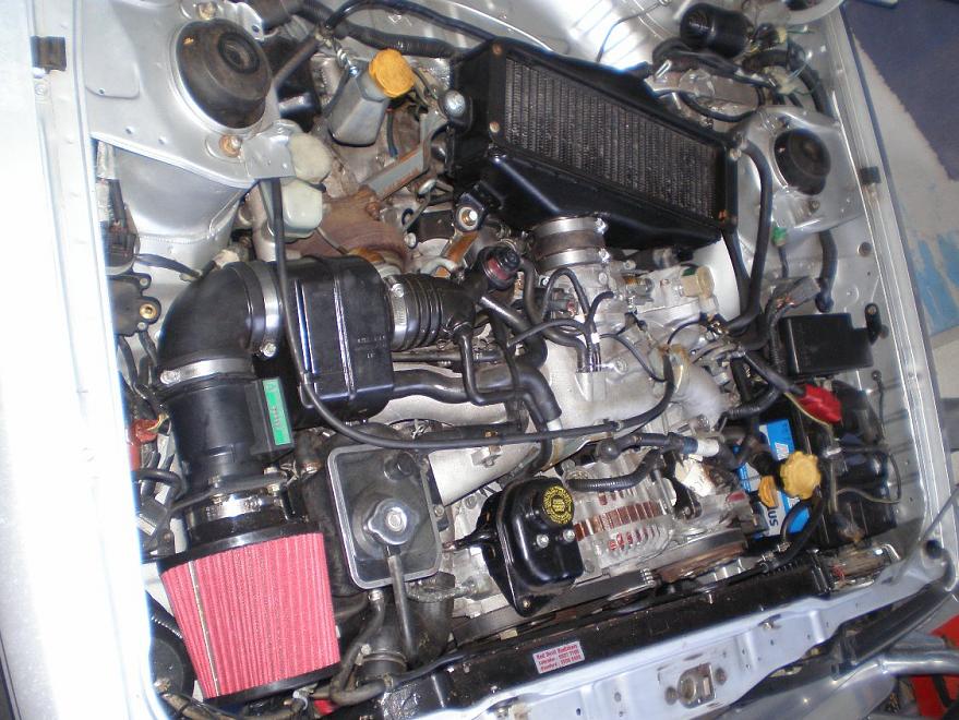

nicely wedged in there its a pity Subaru didn't do something like that for the later brumbys and the motor looks like it should be in there
Is that the brumby radiator squashed in the fit or a wrx one?

Post by brute » Fri Jul 10, 2009 11:09 am
Radiator is the brumby original with modified inlets, not much room. Some more pictures.

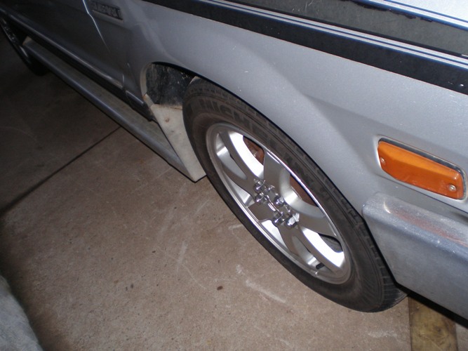

Post by El_Freddo » Fri Jul 10, 2009 4:53 pm
Looking good! Will you keep those rims? They seem to hide in the guard a little I reckon - but thats just my taste in rims ;)
Post by AndrewT » Fri Jul 10, 2009 5:19 pm
Looking very nice there.
How did you achieve the stud pattern change to 5x100 ?

Post by El_Freddo » Sat Jul 11, 2009 8:59 am
phillatdarwin wrote:hi all
how do u get the air to your intercooler so it works .
but i like it nice bit of hard work .
With the top mount air to air you need a scoop - looks like brute needs to add one or swap it for a water to air intercooler (WAIC) as the WAIC doesn't need a bonnet scoop, just a radiator mounted out front with some pipe work and a pump ;)

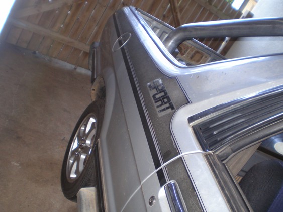

Post by brute » Fri Aug 14, 2009 1:36 pm
Used Crossbred kit for the stud conversion.
For the intercooler im keeping it as is for stealthyness, thinking to add blower / fan to suck fresh air through it which should be efficient.
Can consider sale of car aswell, if anyone interested let me know.

mattw
Posts: 189
Post by mattw » Fri Aug 14, 2009 9:22 pm
as suggested above, get yourself a Liberty RS water to air intercooler.
then you'll have stealth and an effecitive 'cooler.
