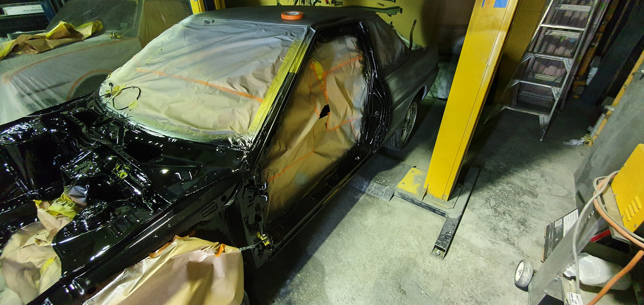

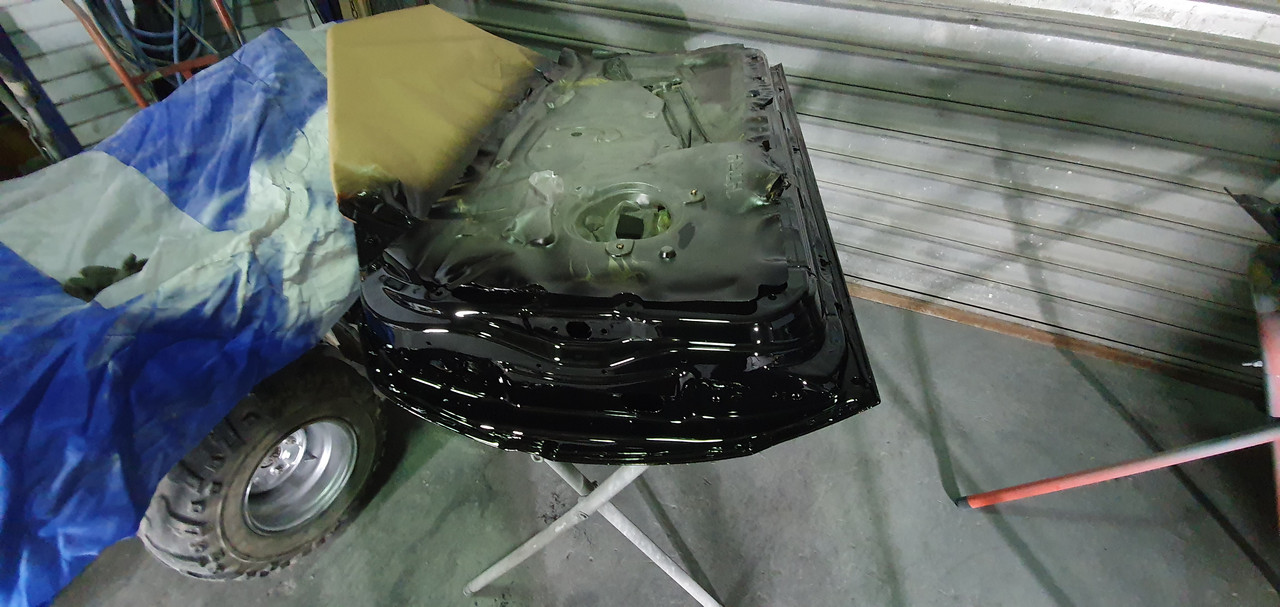

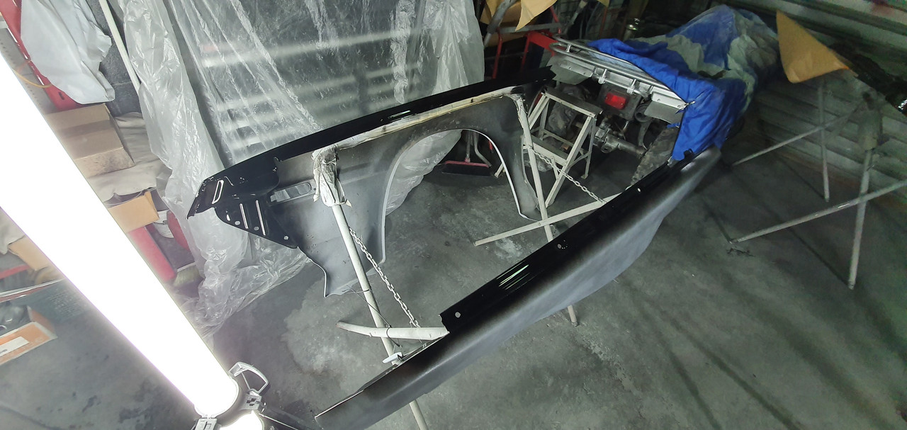

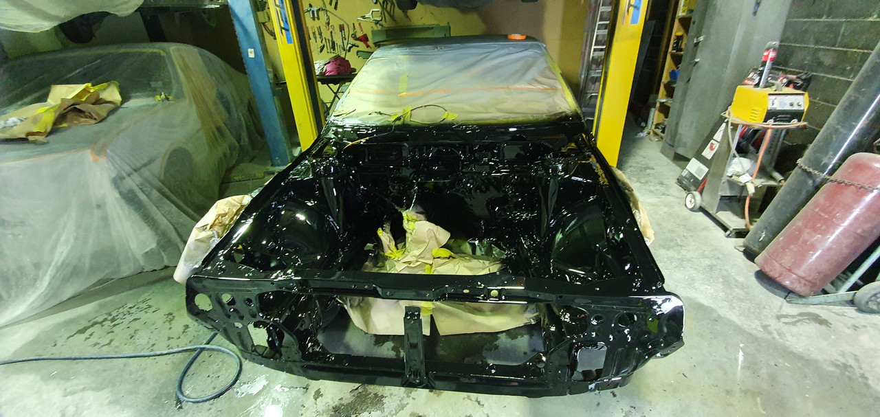

Post by Johnny T » Mon Sep 09, 2019 6:58 am
Here are some photos of what has been done, if everything goes according to plan the car will be in the booth this week.
After the car comes back home going to get the rest of the engine tuned up, replace all the seals and O rings, etc... then put back in and hopefully before the end of the year have it back on the road.
