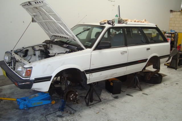

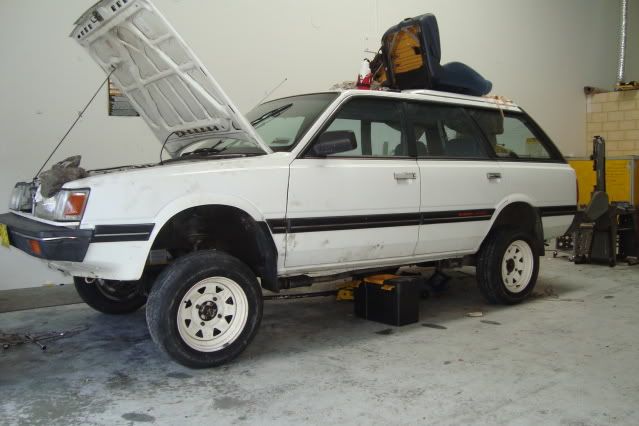

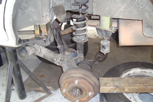

so installing the mighty 4" lift kit now and haven't had a lot of time so haven't been able to knock it on the head yet but know exactly what to do now that i have had a good look at it. One of the holes up front needs re threading which is a bit of a pain but i guess that happens with old cars. should hopefully have it done by this weekend though.
couple of pics and you can see some of the blocks. She looks sad up on the stands fully naked, haha
