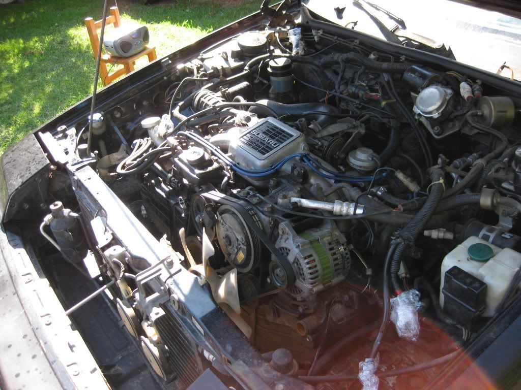

When I started the car a little bit of white smoke came out of the exhaust, the car was almost overheating within 8min of idling and it was also idling at 2400RPM and maxed out revs at 4400RPM (something tells me this is not a good thing for the turbo as-well) but then I adjusted the throttle body back to 900RPM and then now that maxes out to 6500RPM but the car still over heats. Can someone help me out with this cos I do not want to blow the motor.

if it has done that then there is a GOOD chance the heads are toast. most of the EA82 series engines had that issue. I would also look at the cooling system and pump. do you haev bubbles in the radiator with the cap off?

As for the problems you've asked about. The overheating issue could be blown head gaskets as someone's already mentioned. It could be a combination of things since it has been sitting for the last 5 years. The radiator would need to be rodded (cooling channels cleaned out with a rod), the water pump probabily replaced - checked at the very least. I'd change the coolant, best to leave after you've checked everything out. To check for bubbles in the radiator, fill it up, leave the cap off and start the engine, let the engine run while watching for bubbles in the radiator - keep an eye on the temp from time to time as not to overheat the engine.

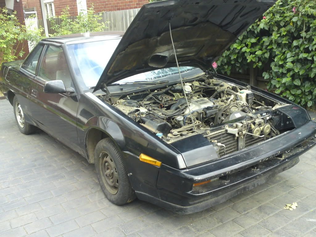

Overall it looks like a pretty neat unit for its age - the only missing piece I've seen so far is the dash surround...

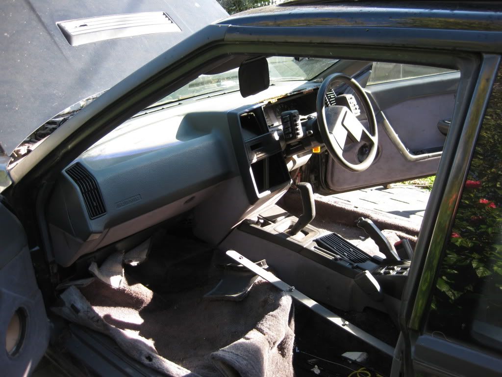

in your first picture you can see the window winder im not sure if you know it, hence why i asked if your a mechanic or such, its the black and silver thing the the middle of the car and the base of the windscreen, normally it would have 3 bolts on the silver bit and the black is just sitting there, it is connected to the windscreen wiper mechanism by a splined joint possilby with a circlip.
