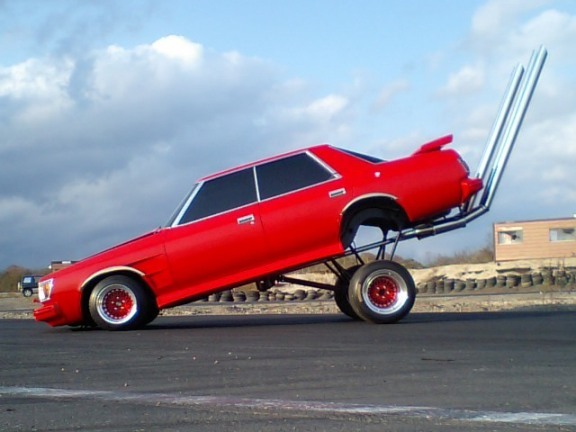

Post by El_Freddo » Tue Oct 15, 2013 9:10 pm
^ That ruins a vortex - where's the subaru about that?
I love the manoeuvrability of my subaru offroad compared to the big rigs! This thing makes a subaru everything it's not!

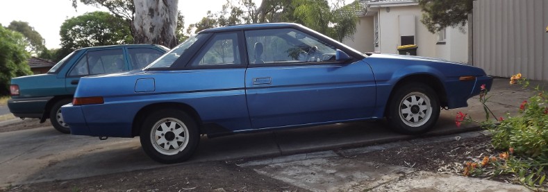

Post by TOONGA » Sun Dec 15, 2013 9:42 am
Ummm did I miss all of this while I was enjoying the new ride height of Jetcar :)
I know every one drops their vortex to just above speed bump level then drops in an EJ20 with the biggest turbo or supercharger they can find... thats why slowly but surely jetcar is getting a "rally" make over... each to his own :)
I can't find the photo of how I want her to look for some reason when ever I want to post the image it has dissapeared :( when I find it next I will post it. the image is of a vortex in rally spec and all the text is in Japanese.
Anyway back to the pinging problem with summer here the heat is making the ping almost horrific when I run the car on 91 ron so Im currently running on 95 ron upwards with no improved fuel economy and a nice dent in my wallet. with 95 ron I still got some ping :(. This morning I changed the computer from a D5 to a 63 (D5 is from a 92 liberty, 63 is from a 89 liberty) Put in a newer coil and changed the 2 prong ECU temp sensor. I took her for a drive (remember 95 ron) and there is no real difference in overall performance but for now there is no ping.
I did the S.U.E.C. (subaru upper engine clean) a while ago with little to no smoke or change to the engine
