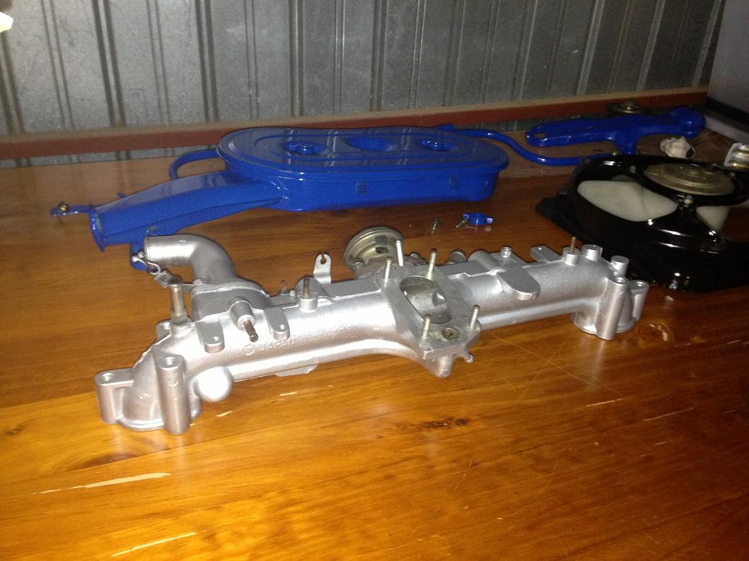

Post by 1983wagon » Mon Aug 19, 2013 8:20 pm
Have decided this will be the feature color along with some black and silver. Pretty close to the Subaru blue so im pretty happy with that. Not sure whether to do the block black or not yet.
suby parts.jpg (109.73 KiB) Viewed 11126 times

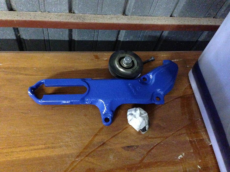

Post by 1983wagon » Fri Aug 23, 2013 6:58 pm
Thought id share what ive been up to :)
