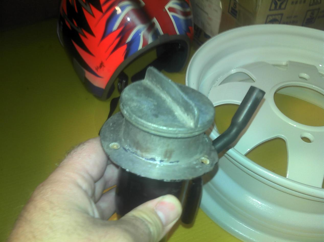

Jules - a viable replacement option is to use a (galvanised I think they are) filler pipe from a circa 1988 - 89 MY Range Rover. Its the 4 door model that has the recessed filler cap and not the one with a flap/cover fitted.
The pipe near enough goes straight on ! Just have to find a rubber bottom elbow. Even has a breather in place too:D
The cap is about 1000 times better than the subie one too !:mrgreen:

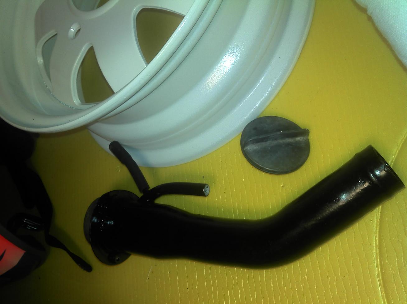

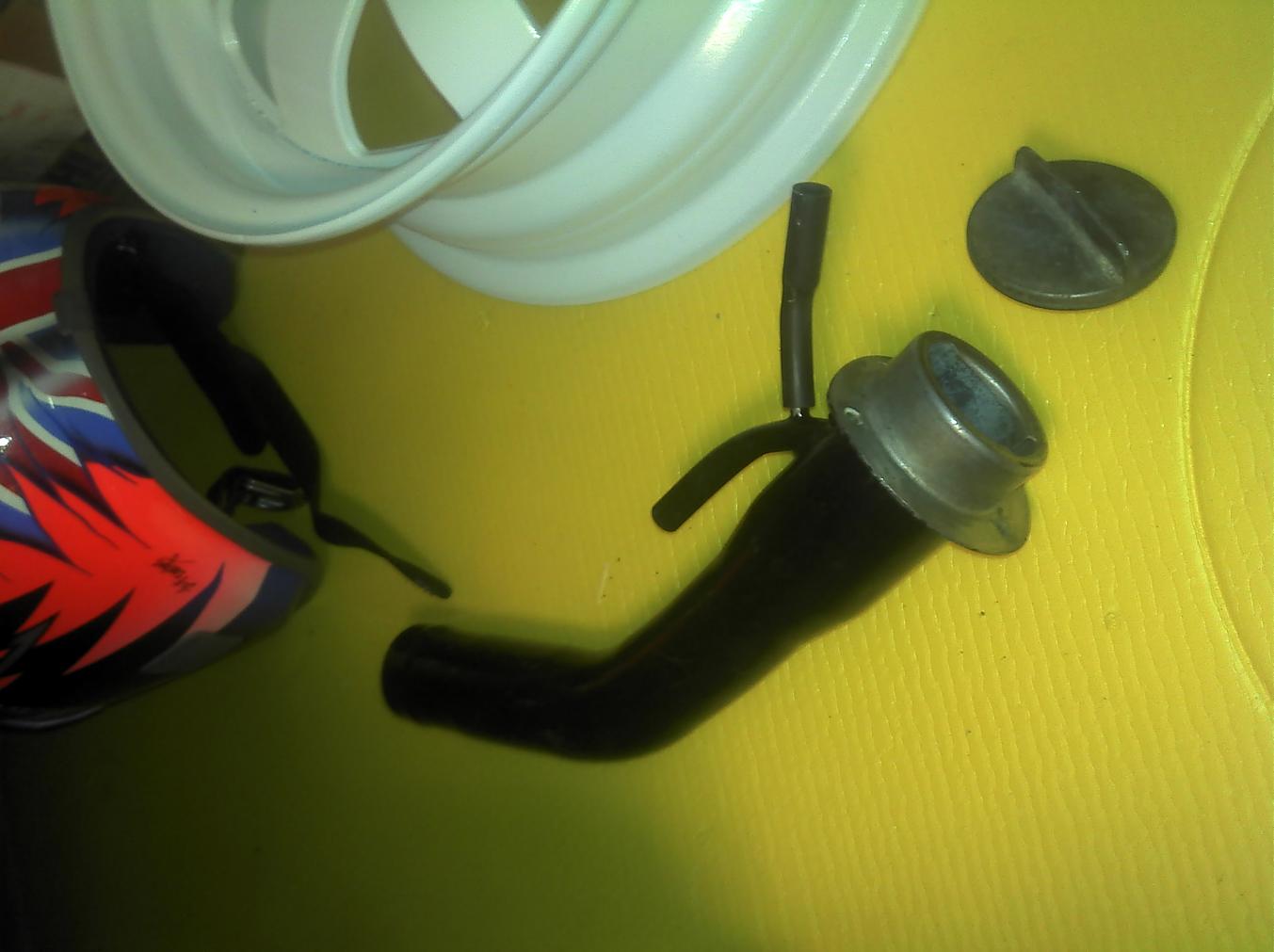

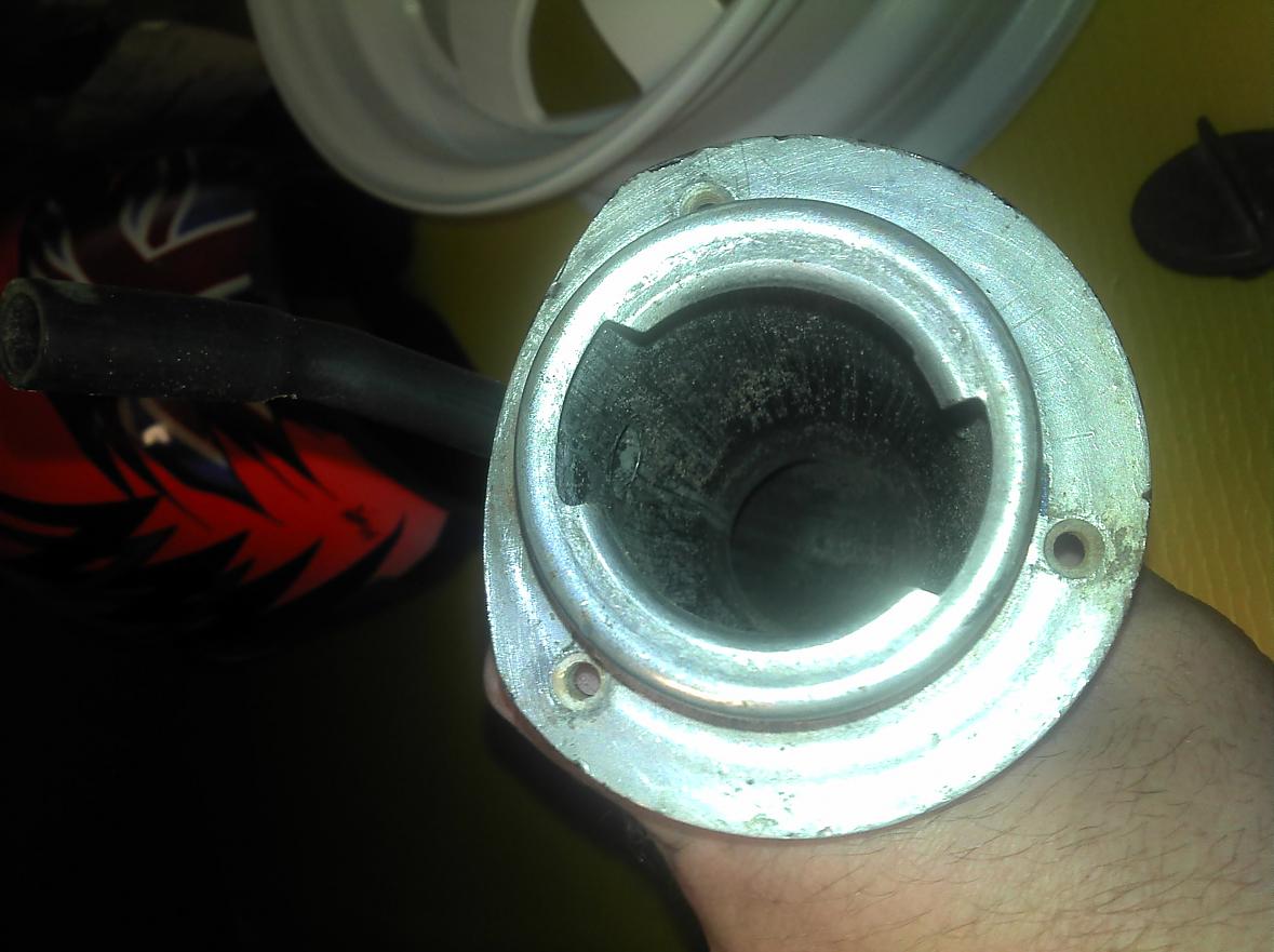

Rangie fuel filler pipe.
Post by 1111giles » Fri May 20, 2011 6:36 am
Firstly let me start a competition as to guessing exactly just how many gallons of petrol will have flowed down this thing over the years ? At about 8 - 12 (best) miles to the gallon quite possibly enough to fill what was the Torre Caynon super tanker ! :mrgreen:
Climbed up into the heady heights of the garage loft earlier this evening and found the Rangie filler pipe,
so here are the images of the pipe which would work on a brumby.
BTW I Like the new ''round'' view in your office Jules - the new wheel really works !
[ATTACH]2704[/ATTACH]
[ATTACH]2705[/ATTACH]
[ATTACH]2706[/ATTACH]
[ATTACH]2707[/ATTACH]

Giles Im sure that would fit but I would need to re-plumb the breather pipes and I can bet you aint going to part with that one :)
