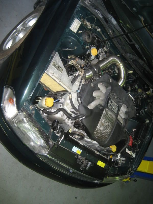

Hi all, this is my latest project. It is a street car but I thought the conversion itself would be relevant to offraod people because I think this engine would be brilliant for a serious offraod Subaru because it has sooo much torque.
I bought the wagon for a reasonable price after selling a previous identical wagon.
I did 127 km in it with the original EJ22 auto driveline before pulling it to bits on a saturday night and fitting a new driveline. I though it'd be a change to go NA so I got hold of an EZ30 out of a 2002 Outback. I mated this up to a V3 STi 5 speed and rear diff. A quick rewire, some V6 STi monotube struts and a set of factory 15's and WRX 277mm brakes and we are away.
I had to add the factory immobiliser system including key and key barrell. It all came together pretty well and fired up first click.
Still had to sort out some plumbing, namely top radiator outlets, exhaust(twin 2" into single 2.5") and finish the air intake(stainless piping to ARC WRX airbox).
Finished the intake, sorted out the drive belts, mounted a WRX fan sideways on the GX radiator and fabricated a tee piece top radiator pipe(EZ30 has two top outlets). Yes it is quite tight up front. :)
ARC airbox.

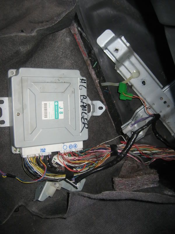

So I have been driving it for a month or so and all is good, surprisingly the ecu doesn't seem concerned with the lack of factory auto(no manual option in this H6). The only hangover from the auto being missing is a slight flare of the revs on lower rpm gear changes as the idle motor must sit in a slightly open position.
The engine is so smooth and torquey, it will happily pull away from walking speed in 4th gear.
So I guess this means a couple of things. The engine can be fitted to a liberty/impreza/forester and work well. And secondly, a factory H6 gen 3 outback can be converted to dual range manual. The only problem with the latter is that in high spec cars with stability control I doubt the VDC or ABS will work without the auto present.

Nice work mate. Looks like a tight fit. was there any major changes like body work or engine mounts?

No cutting of the body work needed. It bolts in place on the factory H6 mounts(different to EJ). I considered it to be very straightforward actually, although conversions are my speciality. Apart from the wiring it is something that the average mechanically competent person could do.
The engine is very linear and quite powerful but I am smitten with the 6 now and want more from it so I have another engine on the way that will get a rebuild with forged pistons and rods to accomodate a pair of turbos.
Cheer. Al.

There's a techical term - H6 "Banger"... Me likes.
I also like your write up that makes it out to sound like you did this in a weekend -
