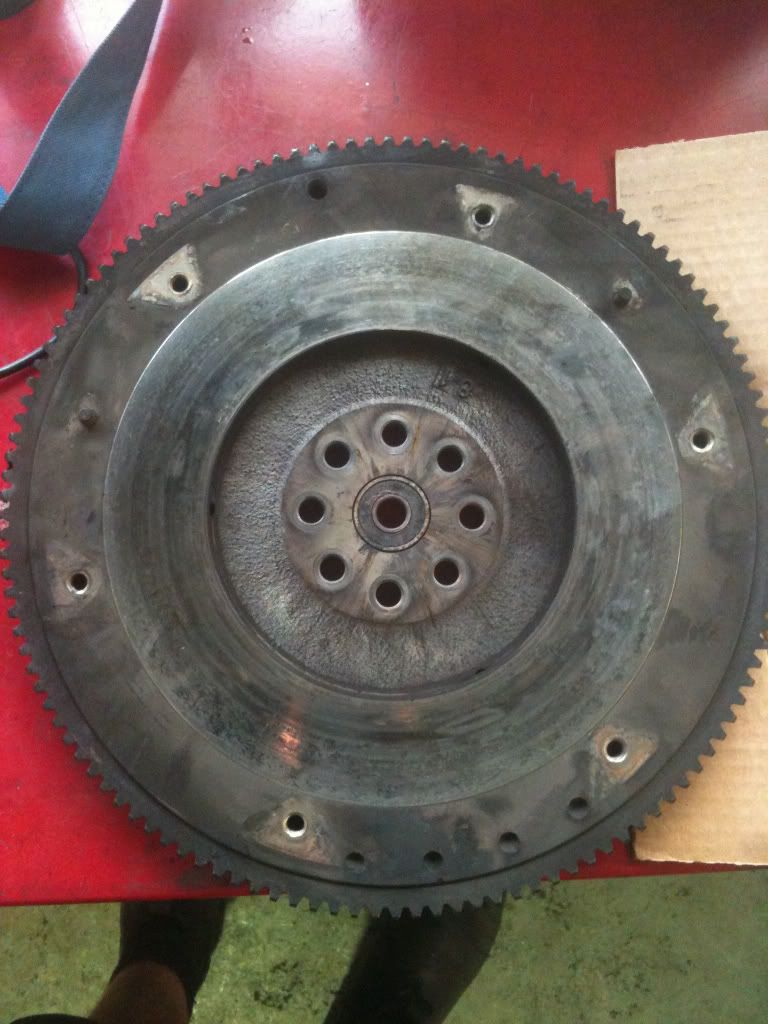

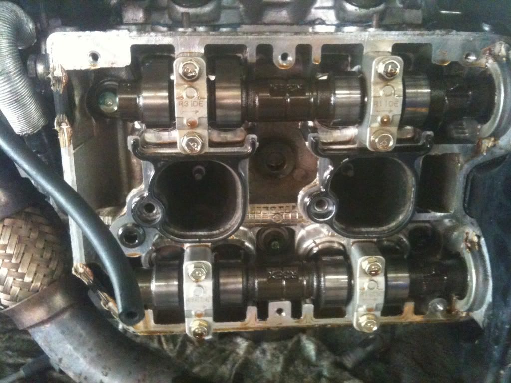

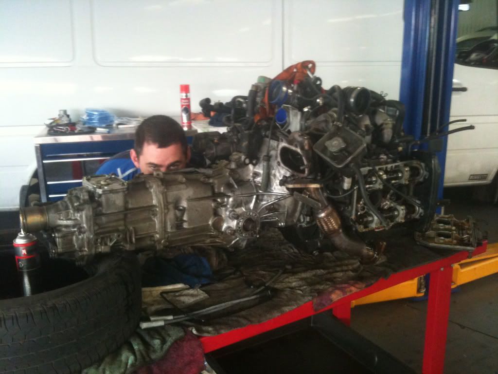

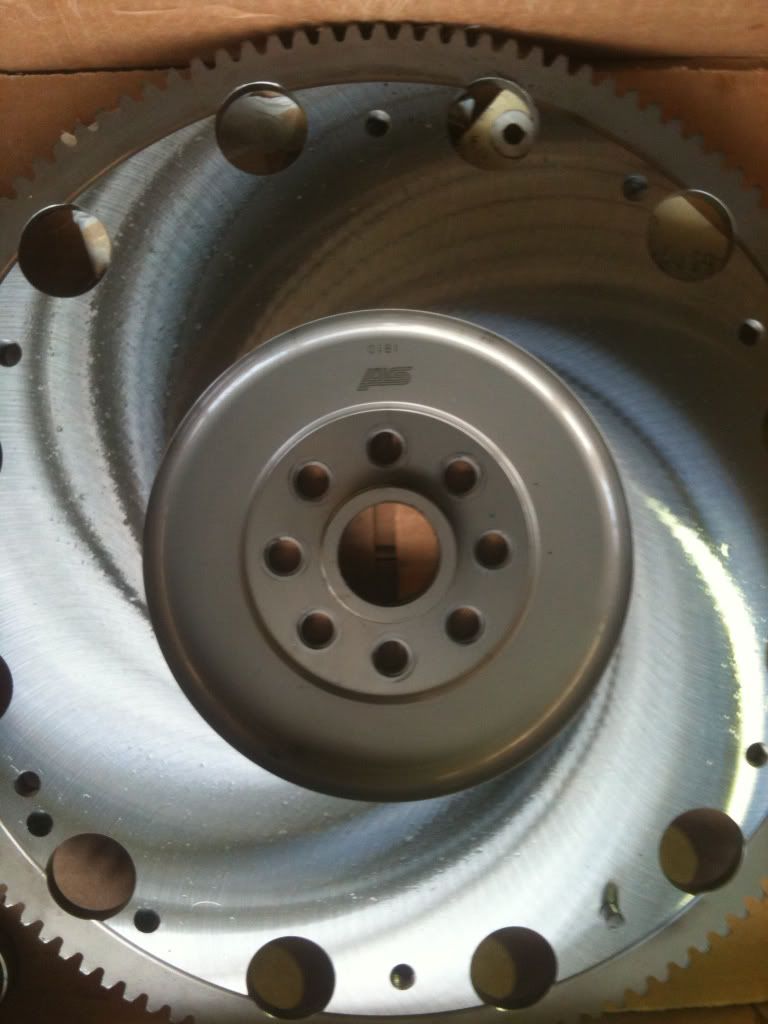

Post by H-top » Sun Jul 31, 2011 7:56 pm
Bennie, THERE IS ALWAYS ROOM FOR MORE BOOST AND SEXYNESS!
Well here are the pics as promised :D
I had a few troubles. The guy that had the car before me replaced a timing belt............................ and forgot to do up the crank bolt.....The balancer came loose, tore shit out of the key and the slot in the crank.....so i need a new crank......
But luckily i have 3 i prepared earlier :D so a rebuild it is but not what i need right now on apprentice wages...
Enough sorrow, here are the pictures!
My old Flywheel
Replace by this GENUINE JDM STi Lightened item
inside the Right hand side cam cover

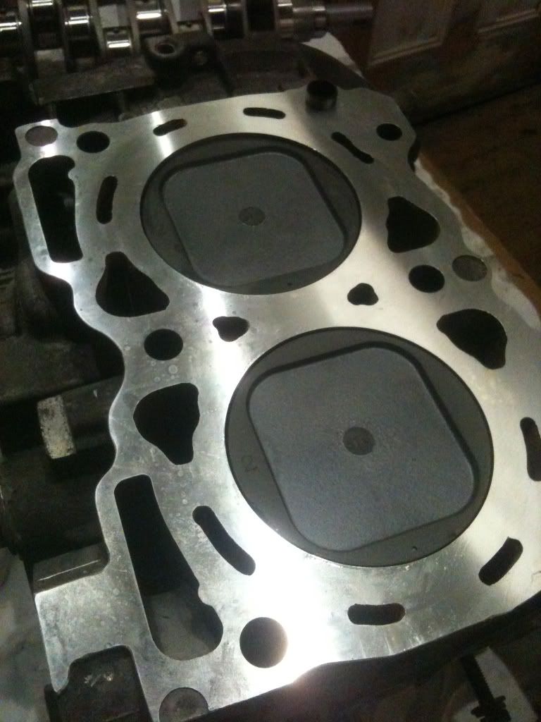

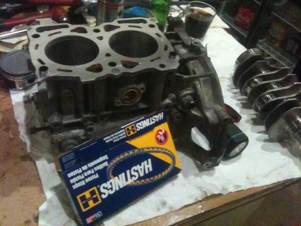

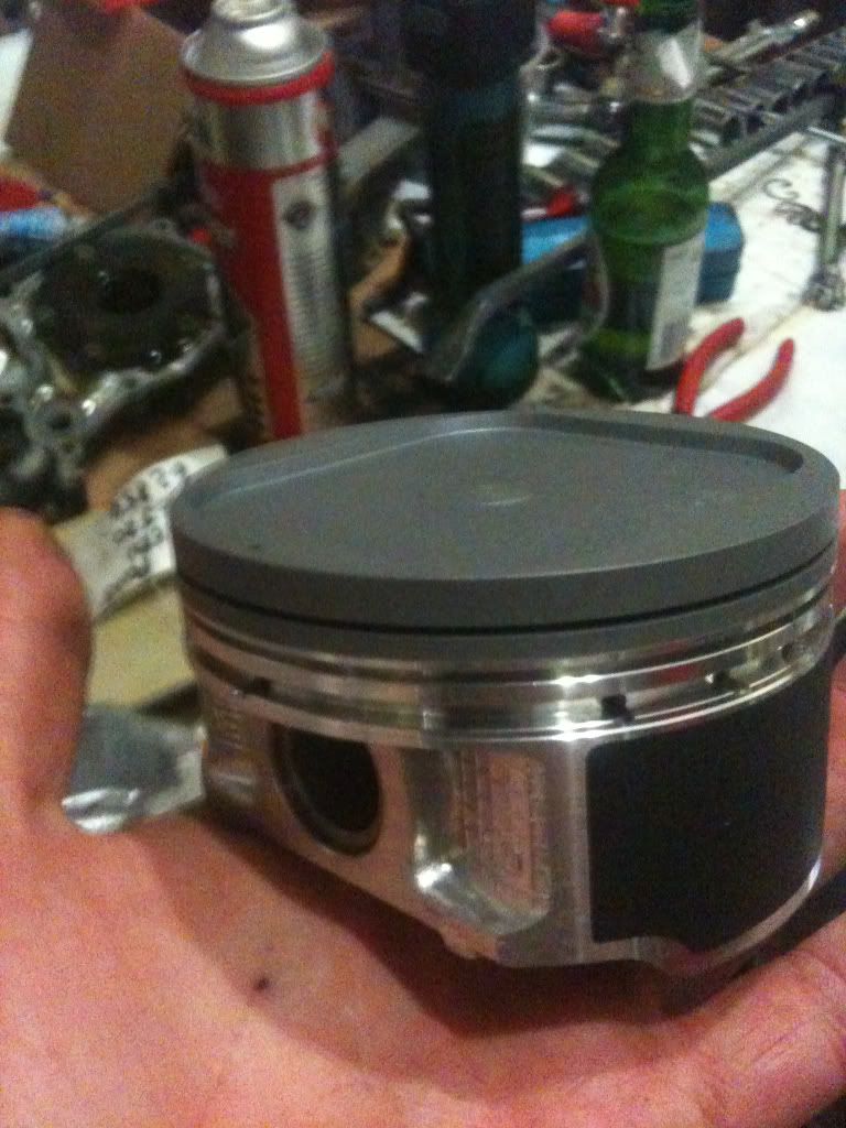

Post by H-top » Thu Aug 25, 2011 5:46 pm
More progress on the build guys.
Crank ground 0.010 over
RS block Decked
Heads Ported
ARP headstead kit
MLS Head Gasket
Ceramic coated pistons with teflon coated skirts
Hastings rings
King Bearings
Nearly built
H-Top
