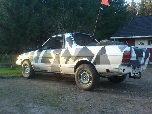

Hello everyone here is a pic of my brat.

thats a ripper of a paint job
well done nice brumby!
Post by Subafury » Fri Jan 12, 2007 8:26 am
awesome- what are the specs?

what a beast ! me like :)
Post by steptoe » Fri Jan 12, 2007 4:20 pm
see those rims..they not 4 stud are they?
suggests EJ ?

yes they are. they look like pug 14" steel rims.

The spec of the car is nothing special pretty much original besides the wheels and paint. But next week there is things going on 1. new wheels going to drill out a set of opel frontera 15 inch rims 2. mount the new set of MT tires 3. crank the susp front with a pair of modified struts (until i get my lift kit). Will be posting more pic for u guys next week.

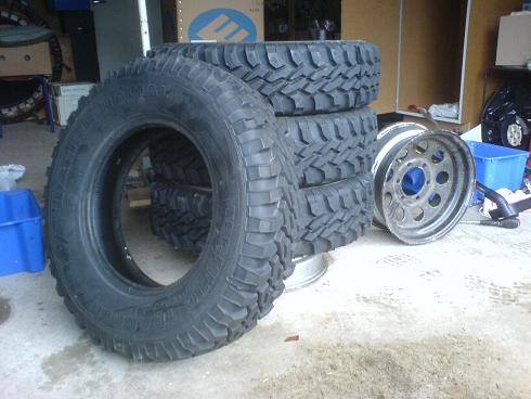

The rollbar on my brat came on another brat i had for spareparts, so i dont know were it came from. The new tires have arrived to my garage and the rims are drilled out. I will be mounting the tires on the rims next week heres a picture of the tires and one rim (not drilled at the pic).
