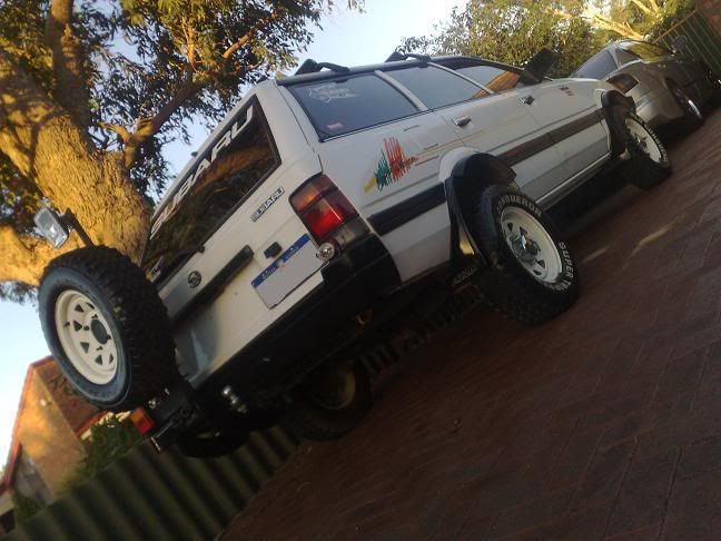

Post by Alex » Mon Feb 11, 2008 7:57 pm
i got bored so i thought i'd make a new thread for the wagon.
I know most of you know the car, but this is for the newbies :)
After a very long time i thought id update
NEW STUFF IN RED
ENGINE
-EJ20G conversion running 14psi
-Custom intake
-custom copper dual core radiator
-gearbox adapter plate
-2.5in dump-pipe back sports exhaust to cannon muffler
-over wrx spec pressure plate and wrx clutch disc + beafed clutch fork
-iridium plugs
-dekla intimidator 1250cca dual use gel cell battery
SUSPENSION/DRIVELINE COMPONENTS
-re-drilled hubs to 15inch 6 stud chrome wheels
-29inch AT tyres
-3inch body lift
-4wd KYB front struts
-2wd KYB rear struts(higher spring base means more lift)
-King spring rears
-lifted lovell front springs
-Nolathane bushes
-Dual range 3.9 gearbox
-Rear LSD
-Liberty power steering rack
VISUAL/INTERIOR GADGETRY
-custom bullbar made by Vidler
-HID headlights
-Lightforce XGT big mofo spottie
-2 forward facing cibie spotties (140w)
-driving lights
-3 rear spotties (all 140w)
-roof racks with fishing rod holders
-dark tint
-big subaru sticker
-wheel flares
-alpine/kenwood speakers and subs + amps
-cb radio + antenna
-tacho in shiny housing
-boost gauge
-wrx seats
-aftermarket steering wheel
-short shifter gear knob
-full shock sensor alarm with motion detectors and central locking
OTHER STUFF
-spare wheel carrier
-custom checkplate bash plate
-strengthened underbody
thanks to the whole wa crew for all the help over the years, and all the 4wing fun we've had, its been great watching all the cars evolve over that short period, much appreciated fellas, particularly D3v1l Dave for all his help.
im sure ive forgotten afew things to add
heres some viewing pleasure :)....THESE PICS ARE OLD!!

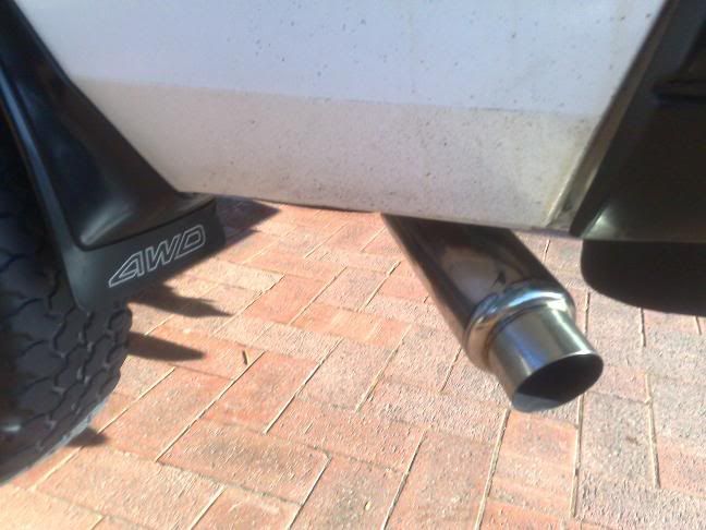

how do the canon and tyre carries go offroad??? they hang down way low
Post by Alex » Tue Feb 12, 2008 1:57 pm
the wheel carrier is still to be modded, as it was originally custom made for Mike's MY i believe.
cannon doesnt cop much, im careful for it, but i can see it taking a knock soon. But its worth the awesome note it produces :)
Posts: 12669
Post by El_Freddo » Tue Feb 12, 2008 2:33 pm
Alex wrote:cannon doesnt cop much, im careful for it, but i can see it taking a knock soon. But its worth the awesome note it produces :)
You mean you like the drone the canon makes, 90% of the note is from the exhaust...
Personally i wouldn't have the canon, but then again, i'm not as attracted to shiny things as you are alex :p
Post by Alex » Tue Feb 12, 2008 6:08 pm
i use to have a strait through sports muffler there. It sounded abit subaru'ey but now its almost identical to a rex. Like no shit.

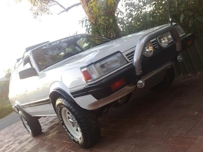

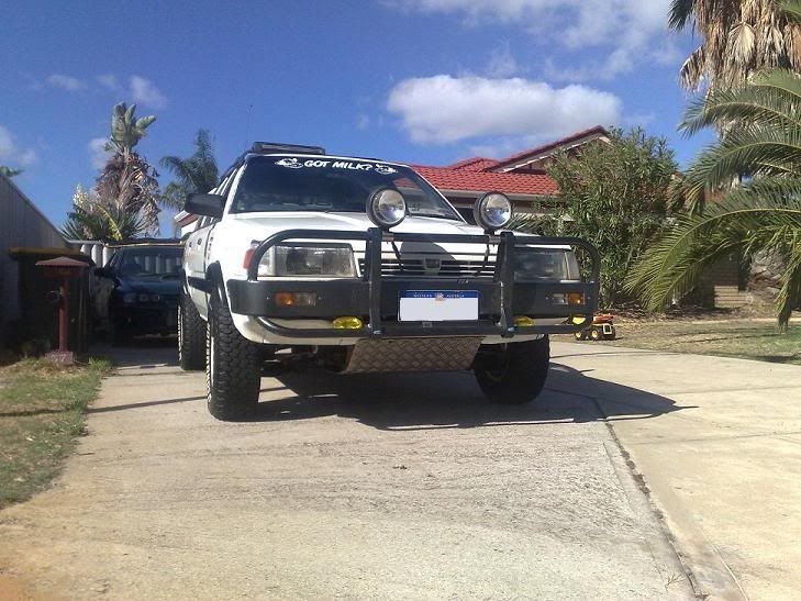

new bullbar
Post by Alex » Sun Feb 17, 2008 10:15 pm
fitted the new bullbar yesterday, came off Lapsed' wagon, professionally made by vidler :D
love it

Post by BrennyV » Sun Feb 17, 2008 10:30 pm
i must admit, thats one sexy bullbar
Hunter S. Thompson
Post by AndrewT » Sun Feb 17, 2008 10:45 pm
Looking great Alex!
Post by Subafury » Sun Feb 17, 2008 10:56 pm
yes it does look good, reminds me of the vidler wagon too much tho
vidler
Posts: 1055
Location: Hamersley WA
Post by vidler » Mon Feb 18, 2008 7:49 am
ha ha, had to look twice to see which car it was in the WA section, there's bit on everything now:)
