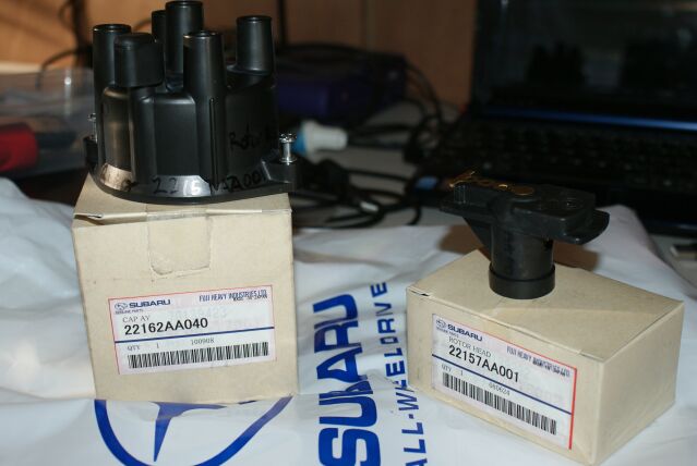

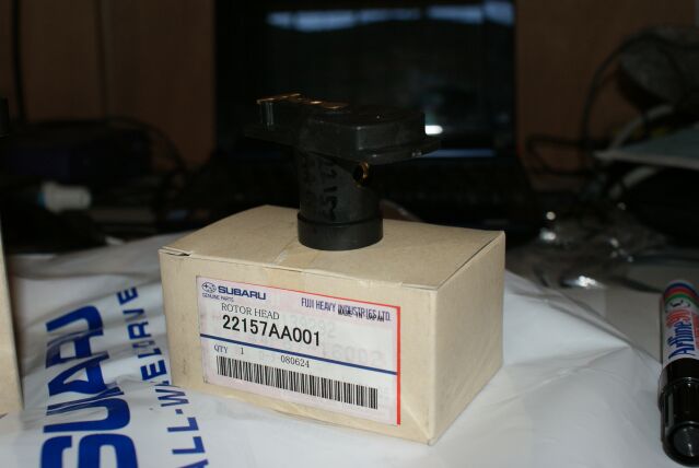

Subaru had the parts imported from Japan in about a week and a half (picked them up and installed them 15/02/12) - Cost for distributor and rotor $116.10. Distributor cap part number 2216AA040, Rotor part number 22157AA001

I have done a little more searching and have discovered this distributor cap no 22162AA040 also fits 6/86 to 2/89 Suzuki Swift 1.3i 16v and Nissan Terrano 2 Z241.
other manufacturers part no's Standard motor products JH180, Airtex/Wells 5D1242, QH XD297, Intermotor 45471, Suzuki 33321-641310, Lucas DDJ, Hitachi 44588-17001,Nissan 22162-17M03/4/5.

Subaru Australia says they don't stock them (22162AA040 - Cap & 22157AA001 - Rotor) have to be shipped from Japan and want $130ish for the pair!?!?
