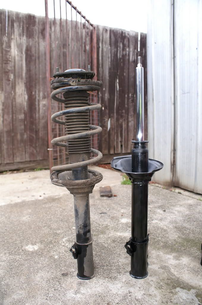

Post by AlpineRaven » Fri Sep 14, 2012 8:03 am
Alex wrote:does an outback strut have more travel? Id be worried about the lower spring sitting loose.
You just cant because the outback struts are longer..
Spot the difference.. the taller one is outback strut and other one is Liberty strut.
